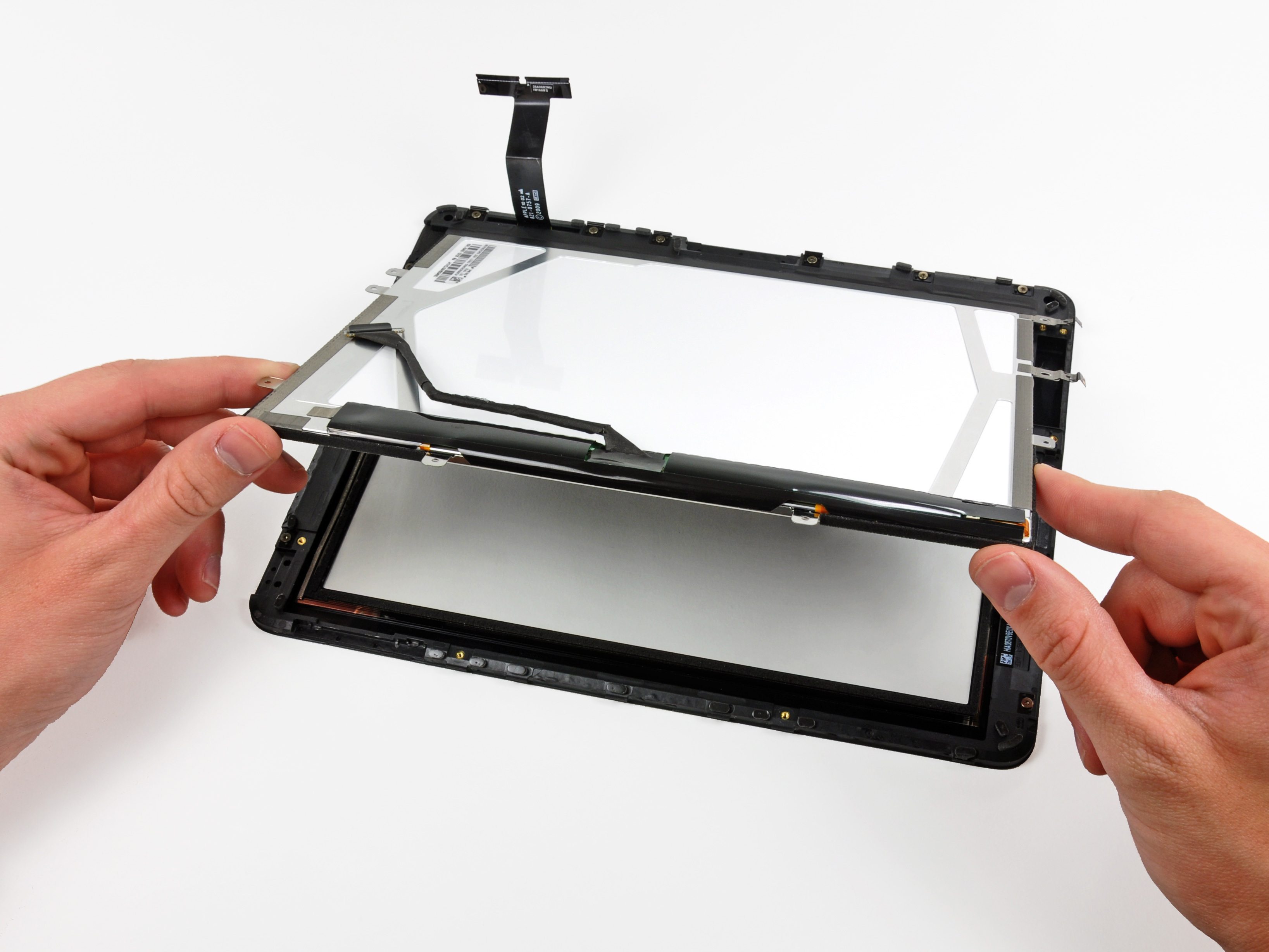

Add Note Edit Step 3  ¶
  • Lift the display assembly away from the rear panel assembly by its bottom edge.
  • Do not attempt to remove the display at this time, as it is attached to the rear panel assembly.
