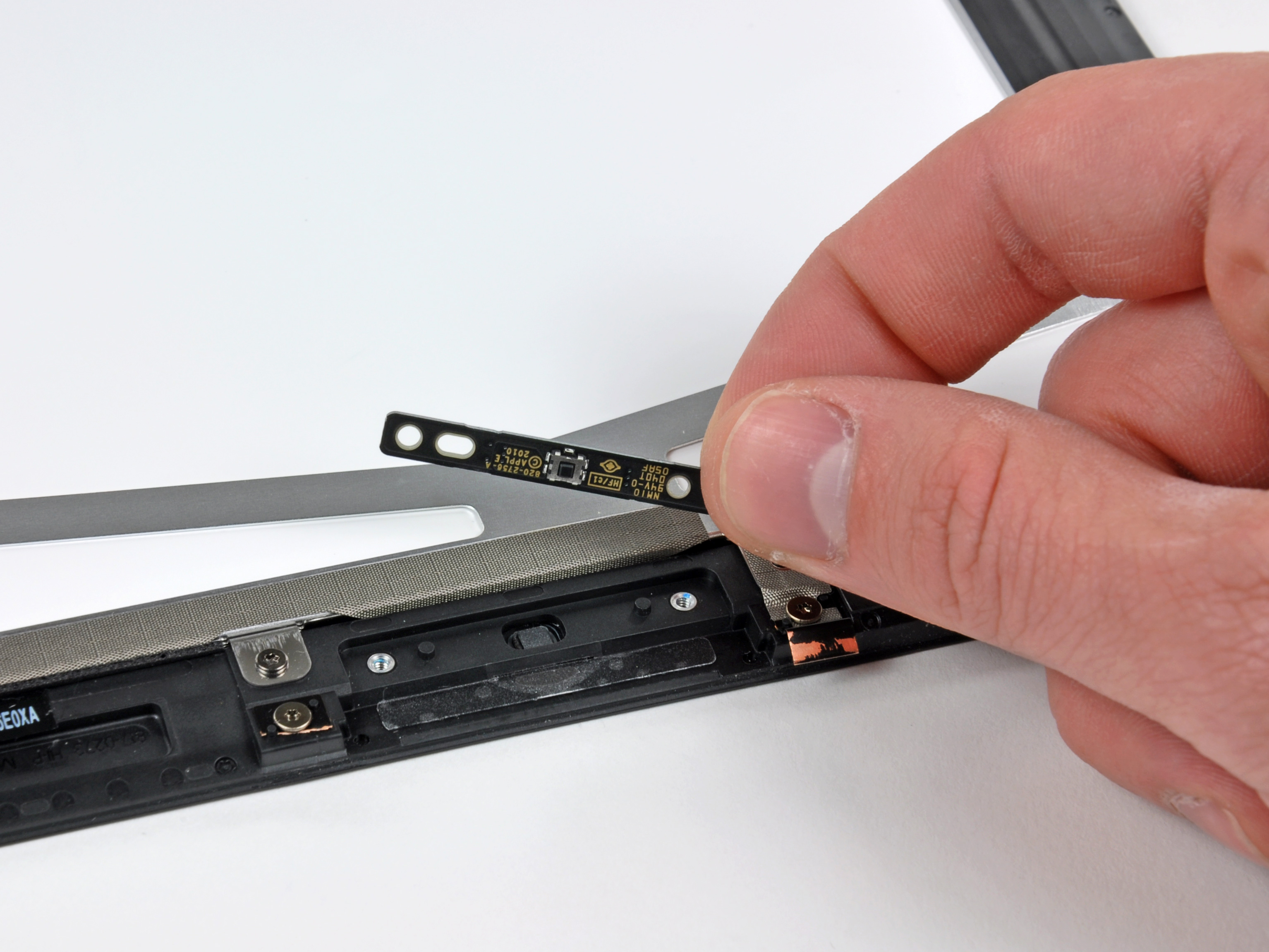

Installing iPad Wi-Fi Home Button Switch
Replace the electronic home button switch on your iPad Wi-Fi.
Use this guide to replace a non-functioning home button switch.

Add Note Edit Step 8  ¶
  • Remove the display assembly from the rear panel assembly.
