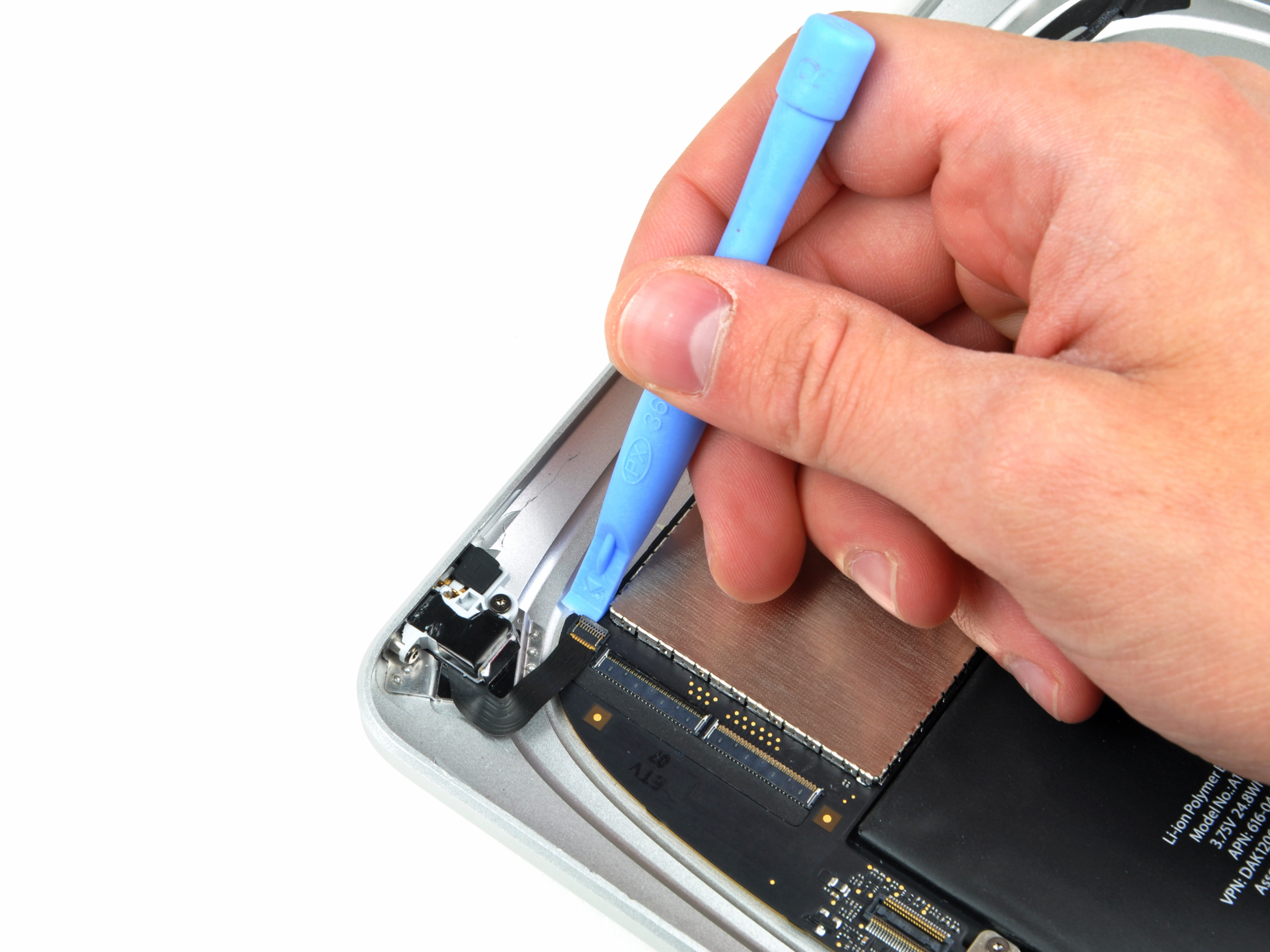

Add Note Edit Step 6  ¶
  • Use a plastic opening tool to remove the ambient light sensor connector from its socket by gently prying upward.
Image #1 Image #2
