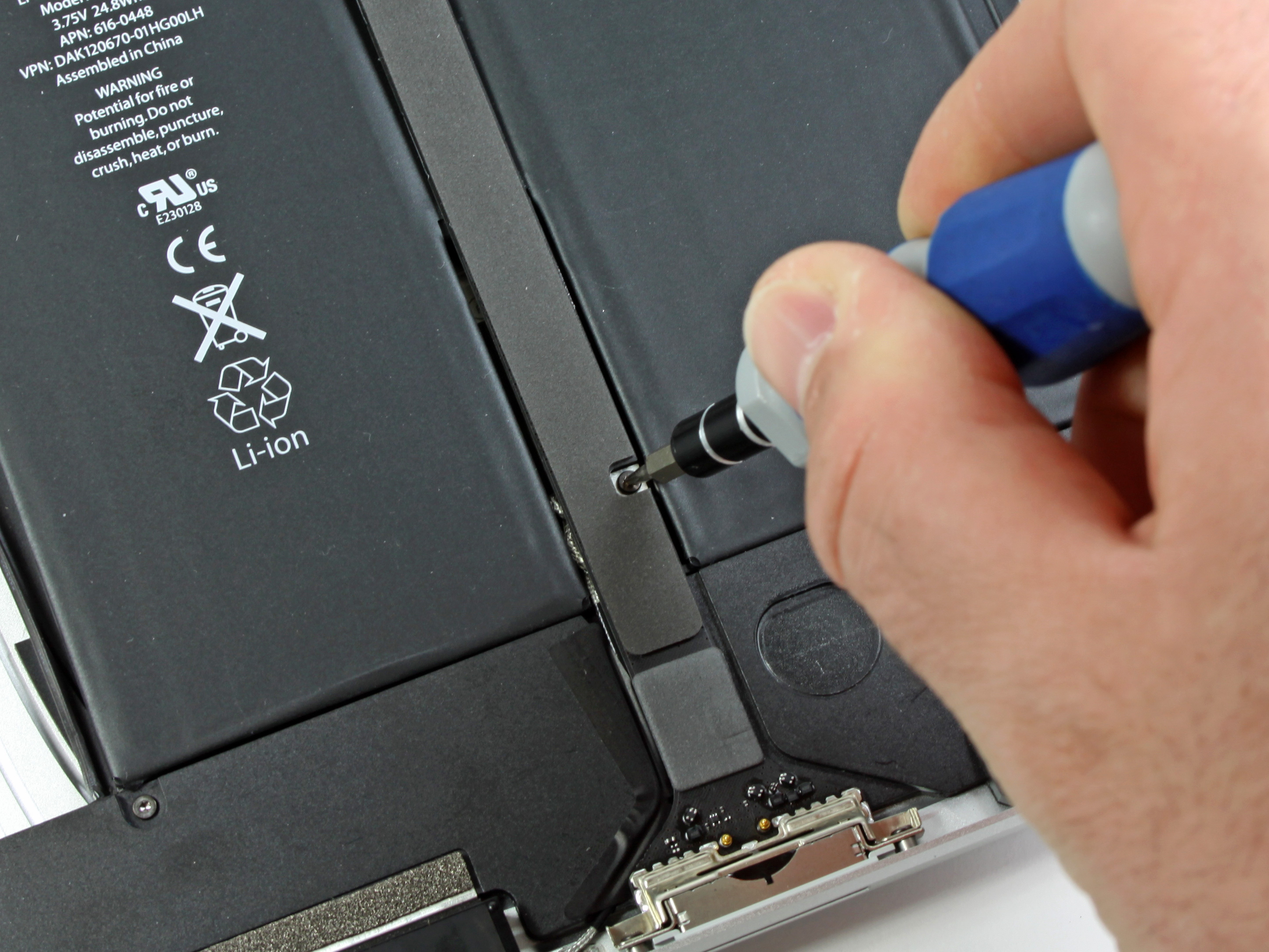

    • Remove the two 4.56 mm T5 Torx screws securing the dock connector cable to the main board.
  12. iPad Wi-Fi Dock Connector Cable Replacement: step 12, image 1 of 1
    • Remove the single 2.84 mm T5 Torx screw connecting the dock connector cable to the rear case assembly.
  13. iPad Wi-Fi Dock Connector Cable Replacement: step 13, image 1 of 1
    • Remove the two 2.84 mm T5 Torx screws securing the dock connector cable to the rear panel assembly.
