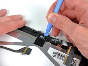

Step 1
Display Assembly
Insert a metal spudger between the top edge of the display assembly and the rear panel assembly.
Rotate the spudger away from you to release the tabs along the top edge of the display.
Insert a second metal spudger between the top edge of the display assembly and the rear panel assembly to keep the tabs from snapping back into place.
Edit
Step 2
With one spudger, work your way along the right edge of the iPad.
The front panel is held to the aluminum back by metal clips on the top, bottom, and left sides. The right side has plastic tabs which slide into recesses in the backplate.
Once the clips are released, lift the left side of the front panel up and slide it to the left to clear the tabs from the aluminum backplate.
