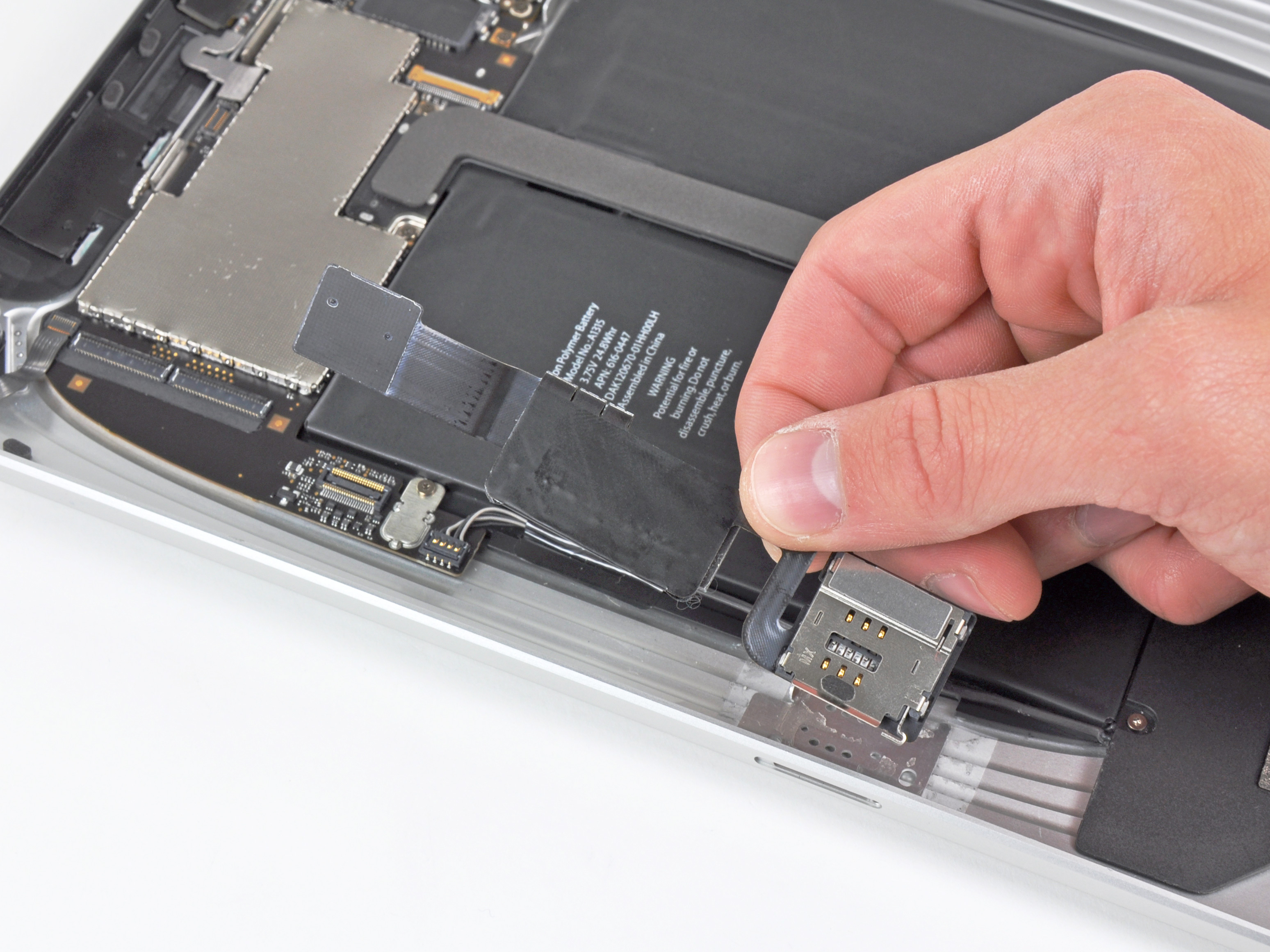

Installing iPad 3G SIM Board
Replace the SIM board and its attached ribbon cable on your iPad 3G.
Use this guide to replace a broken SIM board.

Add Note Edit Step 5  ¶
  • Use the flat end of a spudger to pry the antenna connector closest to the bottom of the iPad up off its socket on the communications board.
Image #1
