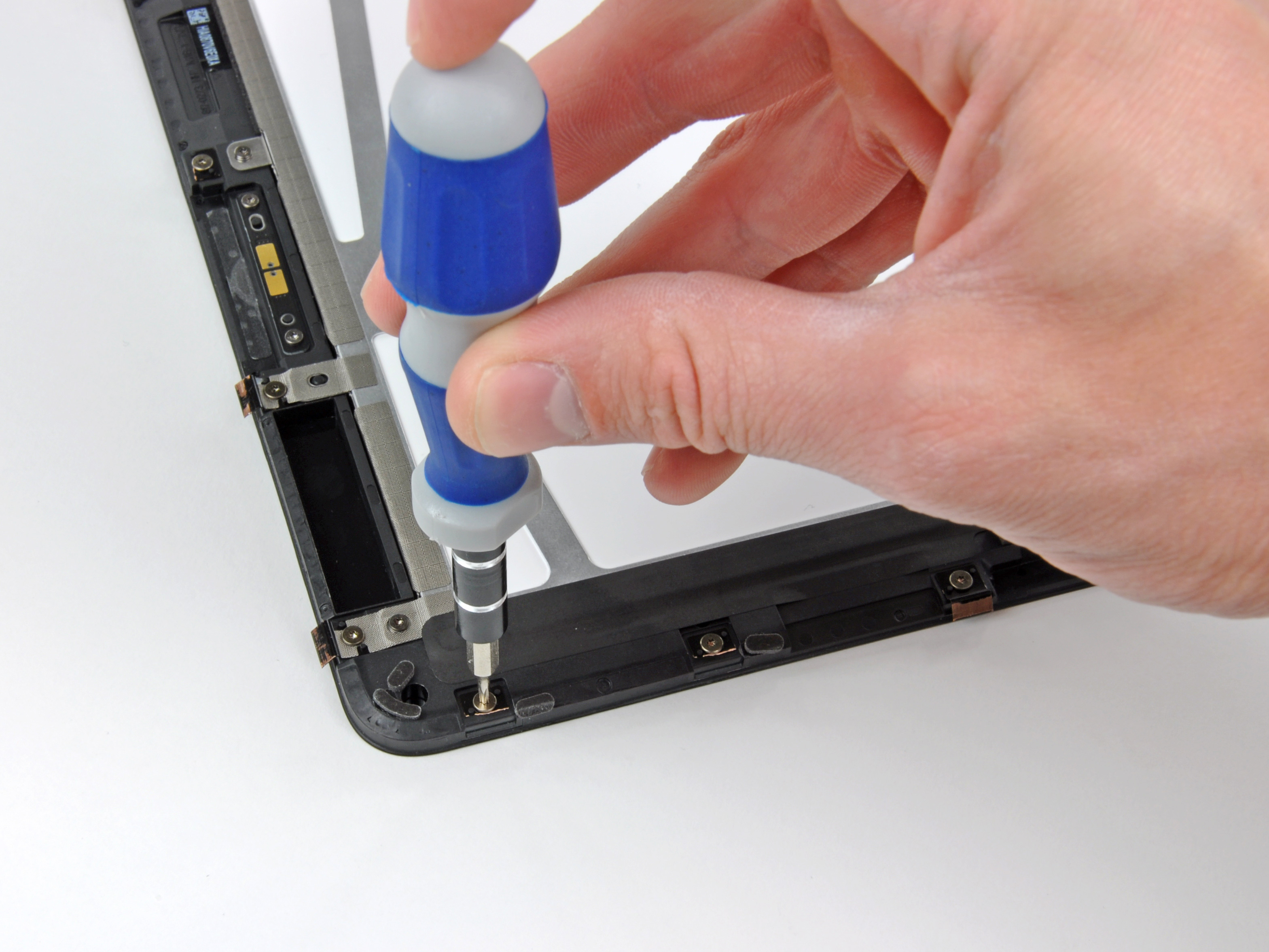

Installing iPad 3G Metal Display Clips
Replace broken metal display clips on your iPad 3G's front panel assembly.
  • Add Note x
  • x 4
Use this guide to replace the small metal clips that are likely to break during removal of the display assembly.

  • The iPad shown in the photos may look slightly different from your iPad, but the procedure is the same.
  • Insert a metal spudger between the right edge of the display assembly and the rear panel assembly.
  • Rotate the spudger away from you to release the tabs along the top edge of the display.
Image #1 Image #2
Add Note Edit Step 2  ¶
  • Insert a second metal spudger between the top edge of the display assembly and the rear panel assembly to keep the tabs from snapping back into place.
  • Pry the display assembly away from the rear panel.
