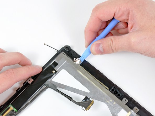

    • Use the edge of an iPod opening tool to carefully pry the ambient light sensor board off the adhesive securing it to the display frame.
    • Once you've gained enough clearance, peel the ambient light sensor off the LCD.
    • If necessary, attach the plastic view window to your new ambient light sensor before installation.

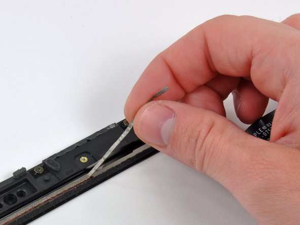

  15. iPad 3G LCD Replacement: step 15, image 1 of 1
    • While holding the digitizer cable down, carefully peel back the piece of tape connecting the digitizer cable to the display frame.

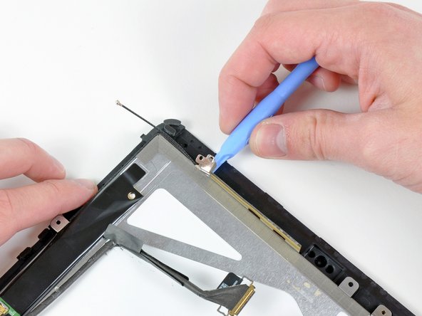

  16. iPad 3G LCD Replacement: step 16, image 1 of 1
    • Use the edge of an iPod opening tool to peel the antenna off the adhesive securing it to the top edge of the display.

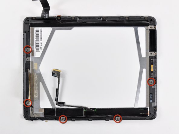

  17. iPad 3G LCD Replacement: step 17, image 1 of 2 iPad 3G LCD Replacement: step 17, image 2 of 2
    • Remove the three T5 Torx screws securing the clips and LCD brackets covered in EMI tape near the home button switch.
    • Carefully peel the display clip and its attached tape off the black plastic display frame.
    • If you are replacing the LCD, be sure to transfer these pieces of EMI tape and their attached clips to the new LCD.
  18. iPad 3G LCD Replacement: step 18, image 1 of 1
    • Remove the remaining T5 Torx screws securing the LCD to the black plastic display frame.

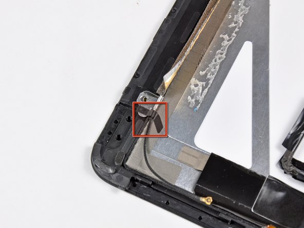

  19. iPad 3G LCD Replacement: step 19, image 1 of 1
    • Remove the small strip of tape securing the antenna lead to the LCD.

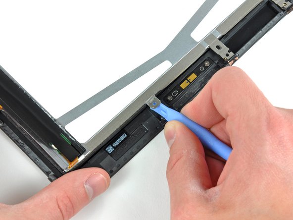

  20. iPad 3G LCD Replacement: step 20, image 1 of 2 iPad 3G LCD Replacement: step 20, image 2 of 2
    • Insert the edge of an iPod opening tool under one of the ears attached to the steel LCD frame.
    • Twist the iPod opening tool to gently pry the LCD up off the adhesive securing it to the front glass panel.
    • Be sure not to excessively bend the LCD, as it is made of glass.

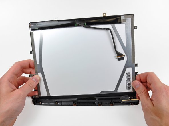

  22. iPad 3G LCD Replacement: step 22, image 1 of 2 iPad 3G LCD Replacement: step 22, image 2 of 2
    • Lift the LCD from its free end, and remove it from the display frame.
    • Carefully peel the adhesive securing the long side of the LCD to the display frame, then remove the LCD.

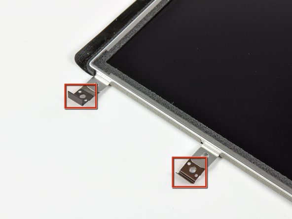

  24. iPad 3G LCD Replacement: step 24, image 1 of 1
    • If they are still in good shape, transfer the clips and EMI tape near the bottom of the LCD to your new LCD.
