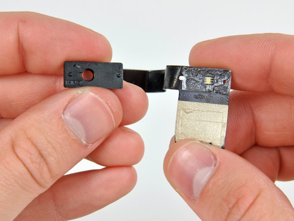

  • Use the edge of an iPod opening tool to carefully pry the ambient light sensor board off the adhesive securing it to the display frame.
  • Once you've gained enough clearance, peel the ambient light sensor off the LCD.
  • If necessary, attach the plastic view window to your new ambient light sensor before installation.

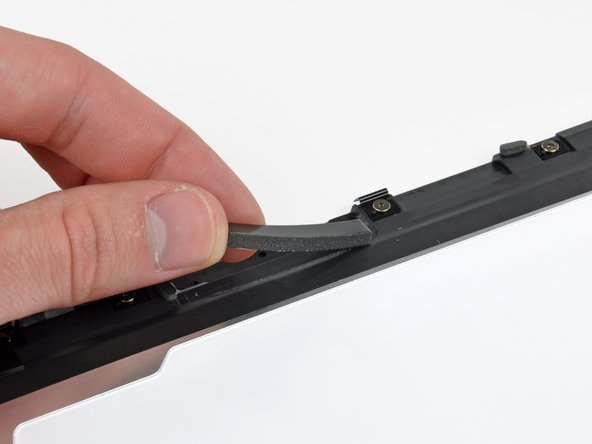

  • If present, remove the strip of foam tape along the long edge of the display assembly near the digitizer cable.

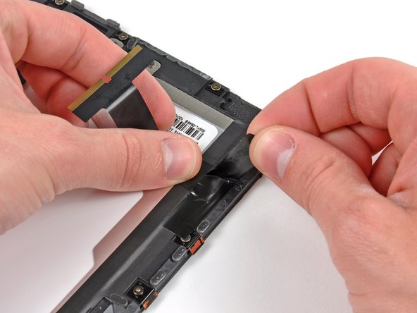

  • While holding the digitizer cable down, carefully peel back the piece of tape connecting the digitizer cable to the display frame.

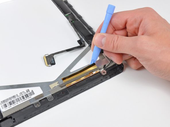

  • Use the edge of an iPod opening tool to peel the antenna off the adhesive securing it to the top edge of the display.

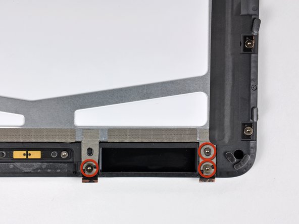

  • Remove the three T5 Torx screws securing the clips and LCD brackets covered in EMI tape near the home button switch.
  • Carefully peel the display clip and its attached tape off the black plastic display frame.
  • If you are replacing the LCD, be sure to transfer these pieces of EMI tape and their attached clips to the new LCD.

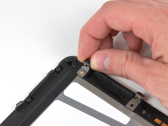

  • If it is still stuck to the front panel, remove the strip of EMI tape near the ambient light sensor socket.
  • If necessary, transfer this to your new LCD.
