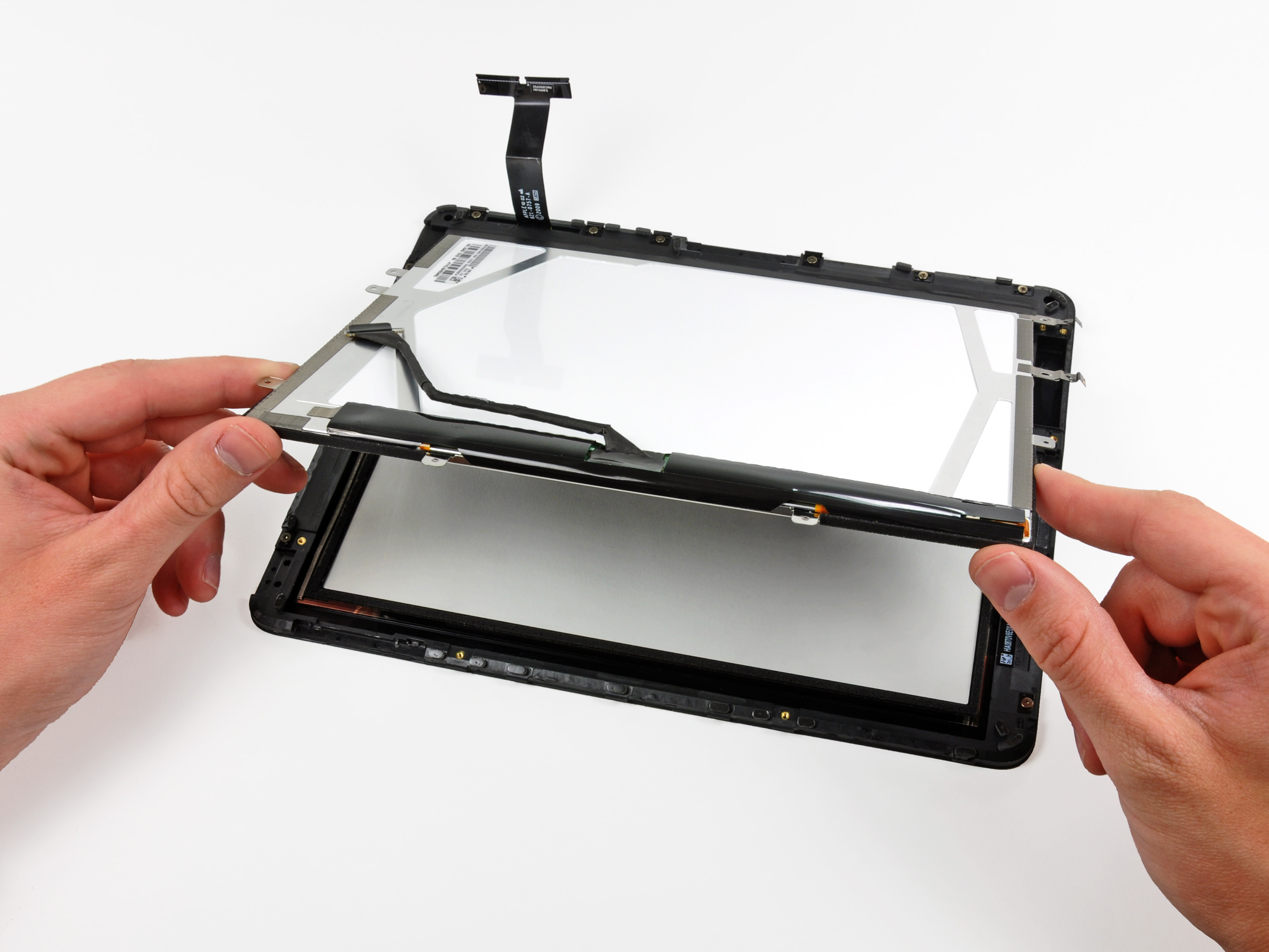

Add Note Edit Step 3  ¶
  • Continue prying the display assembly away from the rear panel along the bottom and left edges of the iPad.
  • Use extreme caution as you approach the top edge of the iPad. The digitizer ribbon cable is located near the edge of the rear panel and can easily be damaged.
