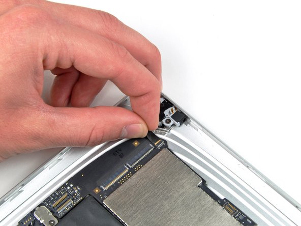

  • Disconnect the display data cable from the main board by flipping up the metal retainer by its black plastic pull tab.
  • Pull the cable connector away from its socket.
  • Pull the connector parallel to the face of the logic board.

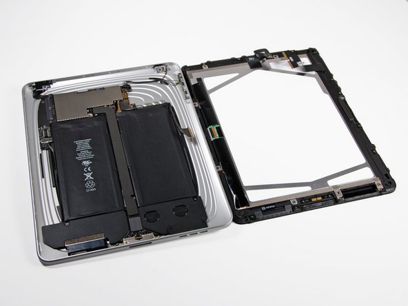

  • Remove the display assembly from the rear panel assembly.

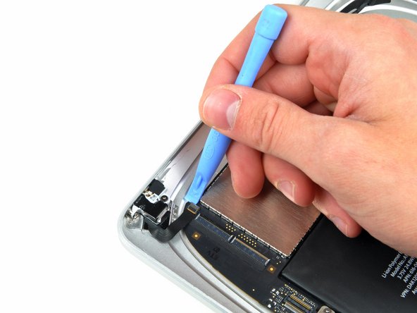

  • Use the edge of an iPod opening tool or your fingernail to flip up the ZIF cable retaining flap on the headphone jack socket.
  • Be sure you pry up on the cable retaining flap, not the socket itself.

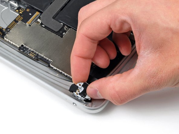

Add Note Edit Step 12  ¶
  • Carefully pull the headphone jack cable out of its socket on the logic board.
Image #1

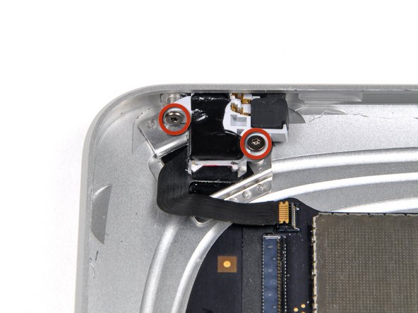

Add Note Edit Step 13  ¶
  • Remove the two 2.8 mm T5 Torx screws securing the headphone jack to the rear case.
Image #1
Add Note Edit Step 14  ¶
  • Remove the headphone jack from the rear case.
  • Make sure you transfer the rubber sound channel from your old microphone to the new microphone.
  • Before reinstalling the screws, be sure the headphone jack is properly seated in the headphone jack hole cut into the top edge of the rear case.
