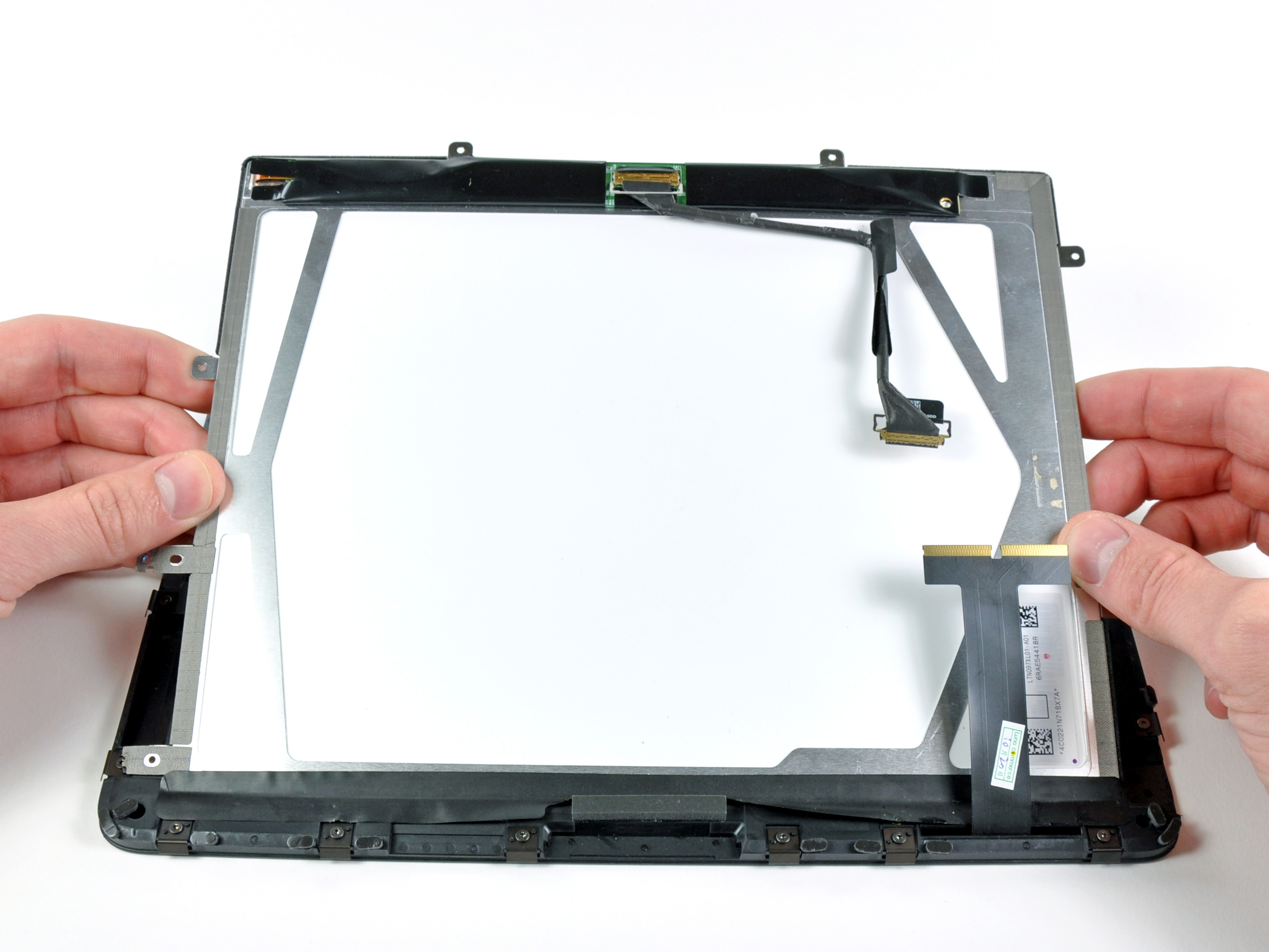

Add Note Edit Step 5  ¶
  • Use the flat end of a spudger to pry the antenna connector closest to the bottom of the iPad up off its socket on the communications board.
Image #1
Add Note Edit Step 6  ¶
  • In the following steps, you will disconnect the three cables attaching the display assembly to the logic board. The cables are for the following components:
    • Digitizer
    • Ambient Light Sensor
    • Display Data Cable
Image #1 Image #2 Image #3
Add Note Edit Step 7  ¶
  • Use the edge of an iPod opening tool to flip up the retaining flaps holding the digitizer ribbon cables in their sockets on the logic board.
  • Be sure you are flipping up the retaining flap, not the socket itself.
  • Pull the digitizer ribbon cables straight out of their sockets.
Image #1
Add Note Edit Step 8  ¶
  • Use an iPod opening tool to remove the ambient light sensor connector from its socket by gently prying upward.
