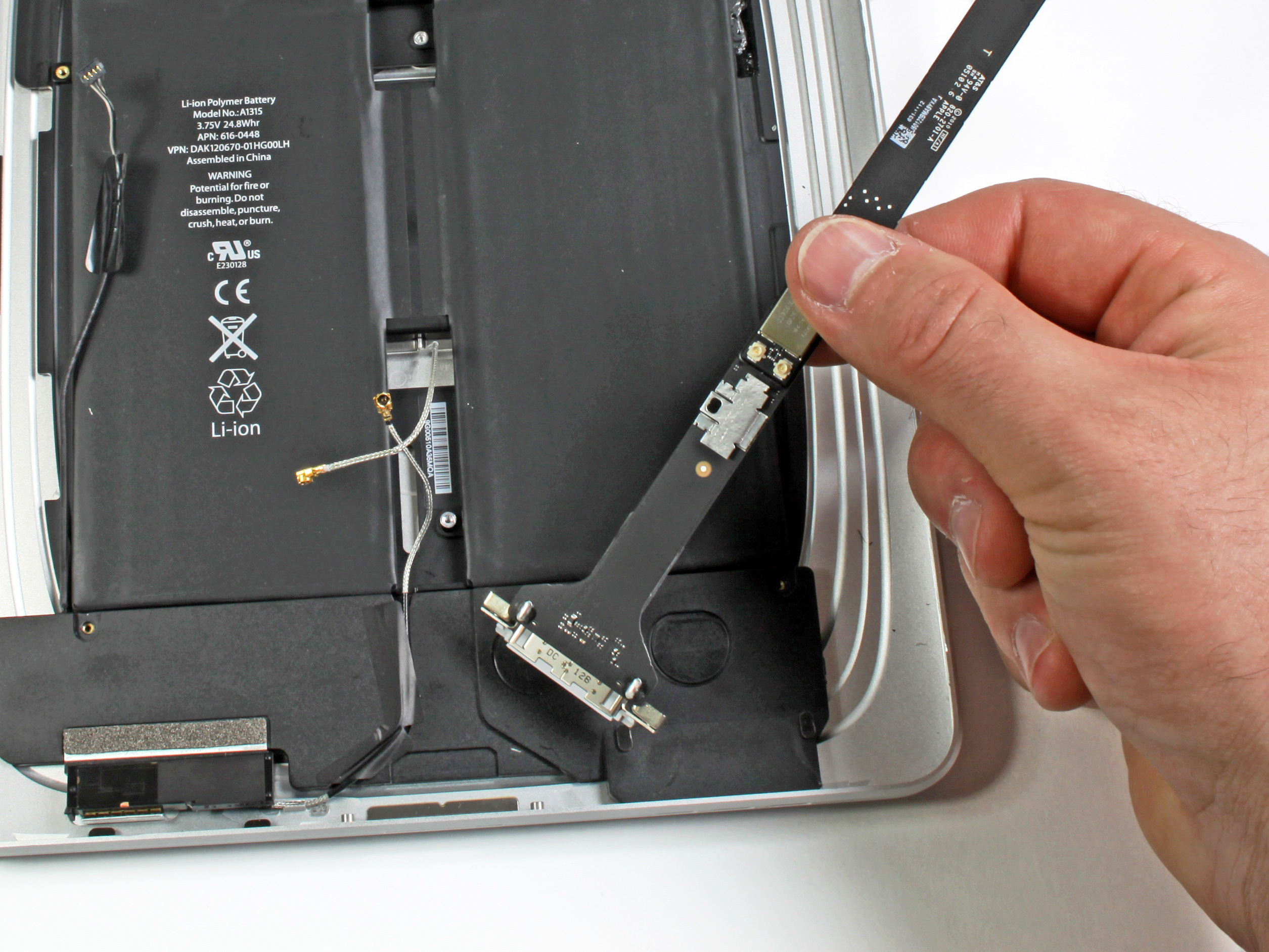

You can use this guide in order to replace your iPad's connector cable.
Image #1 Image #2
Add Note Edit Step 1 — Display Assembly  ¶
  • The iPad shown in the photos may look slightly different from your iPad, but the procedure is the same.
  • Insert a metal spudger between the right edge of the display assembly and the rear panel assembly.
  • Rotate the spudger away from you to release the tabs along the top edge of the display.

  • Insert a second metal spudger between the top edge of the display assembly and the rear panel assembly to keep the tabs from snapping back into place.
  • Pry the display assembly away from the rear panel.

  • Continue prying the display assembly away from the rear panel along the bottom and left edges of the iPad.
  • Use extreme caution as you approach the top edge of the iPad. The digitizer ribbon cable is located near the edge of the rear panel and can easily be damaged.

  • Lift the display assembly away from the rear panel assembly by its bottom edge.
  • Do not excessively lift the display assembly off the rest of the iPad, as a fragile antenna cable with very little slack still connects the two components.

  • Use the flat end of a spudger to pry the antenna connector closest to the bottom of the iPad up off its socket on the communications board.

  • In the following steps, you will disconnect the three cables attaching the display assembly to the logic board. The cables are for the following components:
    • Digitizer
    • Ambient Light Sensor
    • Display Data Cable

  • Use the edge of an iPod opening tool to flip up the retaining flaps holding the digitizer ribbon cables in their sockets on the logic board.
  • Be sure you are flipping up the retaining flap, not the socket itself.
  • Pull the digitizer ribbon cables straight out of their sockets.

  • Use an iPod opening tool to remove the ambient light sensor connector from its socket by gently prying upward.
