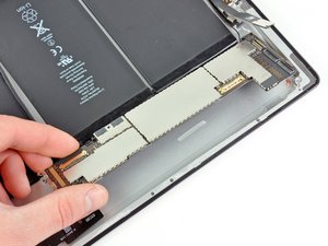

Use this guide to replace a damaged logic board.

Add Note Edit Step 1 — Front Panel  ¶
  • In the following steps, you will be using a microwave to heat the iOpener, an insulated bag that will transfer heat to the adhesive strips around the iPad's screen.
  • We recommend that you clean your microwave before proceeding, as any nasty gunk stuck to the bottom of the microwave may end up stuck to the iOpener.
  • Place the iOpener in the microwave and microwave it for one minute on the highest power setting.
    • Be careful not to overheat the iOpener during the repair procedure. We recommend waiting at least two minutes before reheating the iOpener.
    • If you have not heated your iOpener for some time, or this is the first time you are using the iOpener, we suggest microwaving the bag wrapped in a damp paper towel. This will prevent the contents of the bag from burning in the event of over-microwaving.
