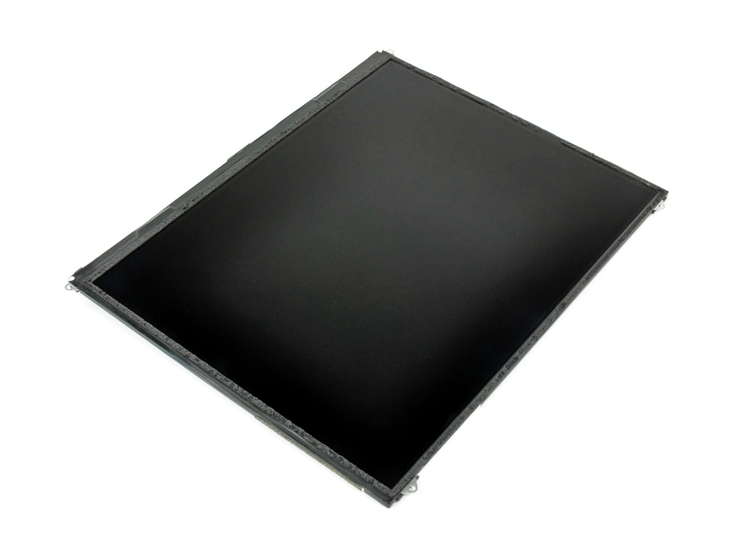

  28. iPad 2 Wi-Fi EMC 2415 LCD Replacement, LCD: step 28, image 1 of 1
    • Remove the four 2.0 mm Phillips screws securing the LCD to the rear case.
  29. iPad 2 Wi-Fi EMC 2415 LCD Replacement: step 29, image 1 of 2 iPad 2 Wi-Fi EMC 2415 LCD Replacement: step 29, image 2 of 2
    • Lift the LCD from its long edge closest to the volume buttons and rotate it out of the rear case.
    • Lay the LCD on the front panel as seen in the second picture.
  30. iPad 2 Wi-Fi EMC 2415 LCD Replacement: step 30, image 1 of 1
    • Use the edge of a plastic opening tool to flip up the metal retaining clip securing the display data cable to its socket on the logic board.
  31. iPad 2 Wi-Fi EMC 2415 LCD Replacement: step 31, image 1 of 1
    • Pull the display data cable out of its socket on the logic board.
    • Do not lift upward on the display data cable connector as you disconnect it.
  32. iPad 2 Wi-Fi EMC 2415 LCD Replacement: step 32, image 1 of 1
    • Remove the LCD assembly from the iPad 2.
  33. iPad 2 Wi-Fi EMC 2415 LCD Replacement, Display Data Cable: step 33, image 1 of 2 iPad 2 Wi-Fi EMC 2415 LCD Replacement, Display Data Cable: step 33, image 2 of 2
    • Remove the small strip of black tape covering the display data cable connector on the LCD.
  34. iPad 2 Wi-Fi EMC 2415 LCD Replacement: step 34, image 1 of 1
    • Use the edge of a plastic opening tool to flip up the metal retaining clip on the display data cable connector.
  35. iPad 2 Wi-Fi EMC 2415 LCD Replacement: step 35, image 1 of 1
    • Pull the display data cable straight back out of its socket and remove it from the LCD.
    • Do not pull upwards on the display data cable as you disconnect it, as this will destroy the socket.
  36. iPad 2 Wi-Fi EMC 2415 LCD Replacement, LCD: step 36, image 1 of 1
    • LCD remains.
