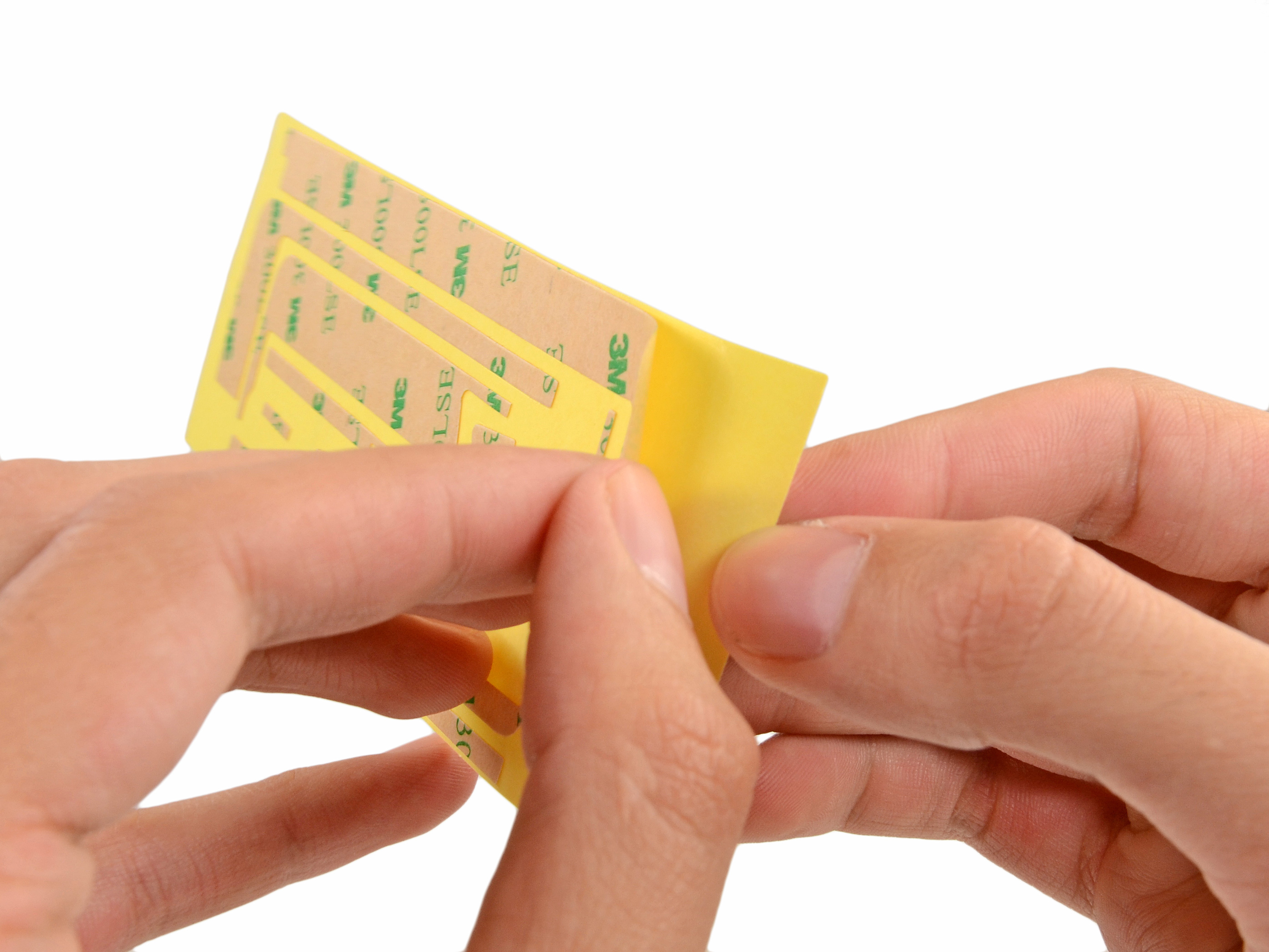

Replace the adhesive securing the front panel to the rear case of your iPad 2 Wi-Fi.
Before you begin peeling and sticking tape, it's important to have clean adhesion surfaces on both the front panel and the rear case. Use a spudger to scrape off any large excess bits of original adhesive, then clean all of the gluing surfaces with a paper towel and rubbing alcohol or Goof Off.
Throughout this procedure, it is recommended to peel up each adhesive strip as needed.

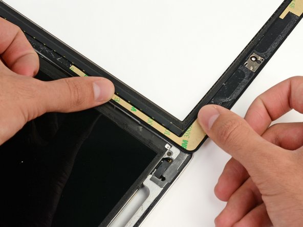

Step 6
In the following steps, you will be placing the remaining pieces of adhesive on the front panel.
Do not peel the brown backing off the strips just yet.
Place the largest L-shaped adhesive strip on the top left corner of the front panel.
Smooth the strip down from the center out, taking care to not trap any air bubbles between the strip and the front panel.
