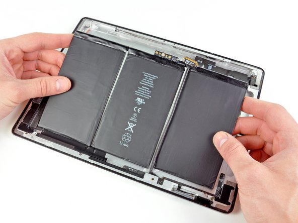

  • Carefully lift the battery out of the rear panel and remove it from the iPad 2.
Image #1 Image #2

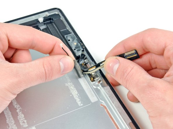

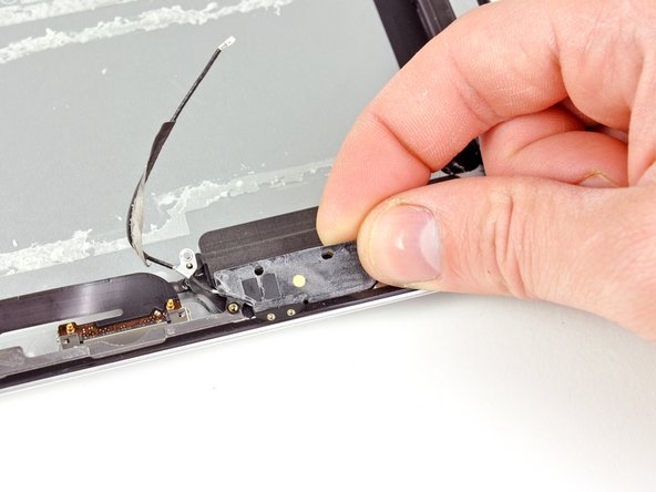

Add Note Edit Step 50 — Speaker Assembly  ¶
  • Carefully peel up the dock connector and speaker cables to reveal the Wi-Fi antenna cable.
  • Peel the Wi-Fi antenna cable off the rear panel.
Image #1
Add Note Edit Step 51  ¶
  • Remove the following four screws:
    • Two 2.0 mm Phillips screws
    • Two 1.7 mm Phillips screws
Image #1
Add Note Edit Step 52  ¶
  • Peel the Wi-Fi antenna off the speaker enclosure and remove it from the iPad 2.
Image #1

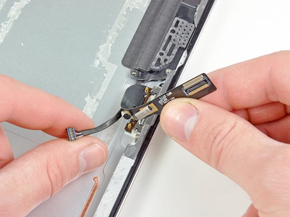

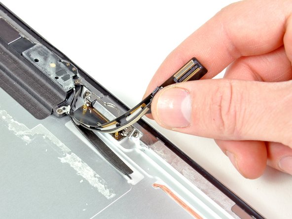

Add Note Edit Step 53  ¶
  • Peel the dock connector cable off the speaker cable.
  • Be sure the small rings of EMI foam remain stuck to the dock connector cable.

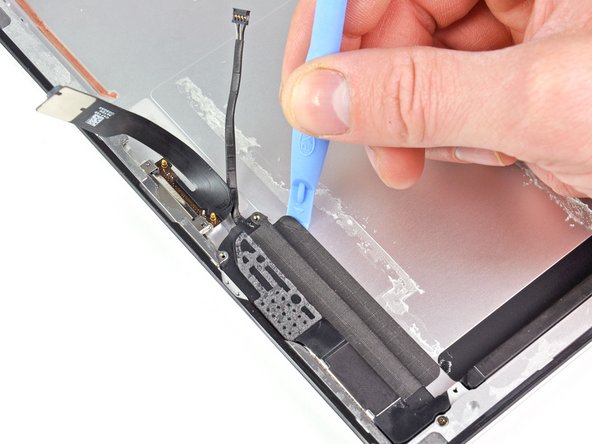

Add Note Edit Step 54  ¶
  • Use the edge of a plastic opening tool to peel up the edge of the large strip of tape securing the speaker assembly to the rear panel.
  • Use your fingers to peel the strip of tape off the speaker assembly.

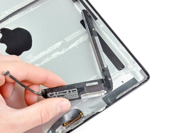

Image #1

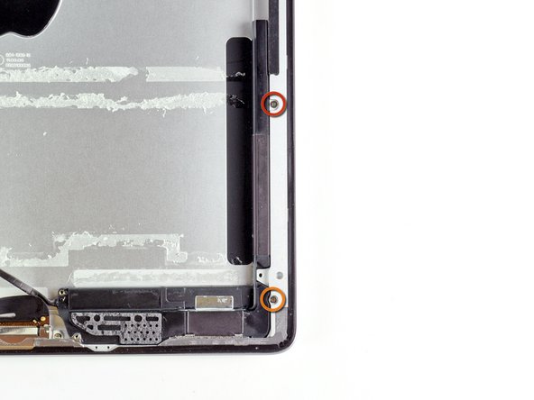

Add Note Edit Step 55  ¶
  • Remove the following two screws:
    • One 3 mm Phillips screw
    • One 2.1 mm Phillips screw

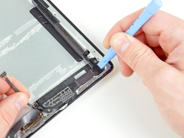

Image #1 Image #2
Add Note Edit Step 56  ¶
  • Use the edge of a plastic opening tool to help push the speaker assembly out from under the right side of the rear panel.
  • Remove the speaker assembly from the iPad 2.
