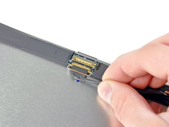

Add Note Edit Step 33  ¶
  • Pull the display data cable straight back out of its socket and remove it from the LCD.
  • Do not pull upwards on the display data cable as you disconnect it, as this will destroy the socket.

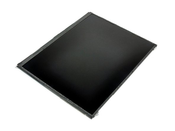

Add Note Edit Step 34 — LCD  ¶
  • LCD remains.
