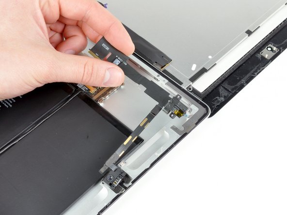

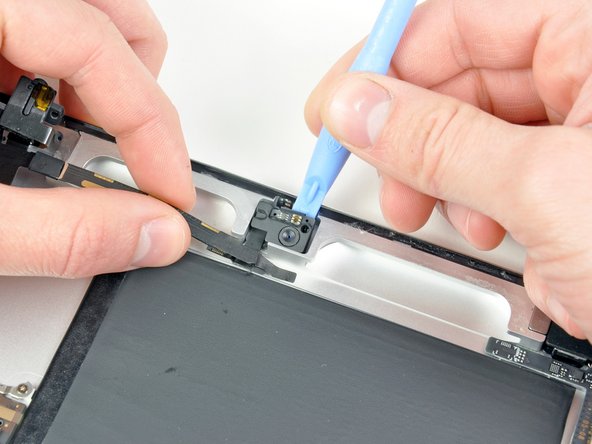

  • Peel the front camera off the foam adhesive securing it to the rear panel.
  • Remove the headphone jack & front camera assembly from the iPad.

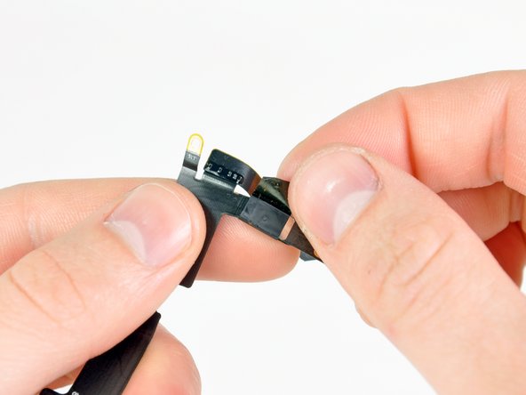

Add Note Edit Step 34  ¶
  • Carefully remove the strip of tape covering the front camera cable connector.

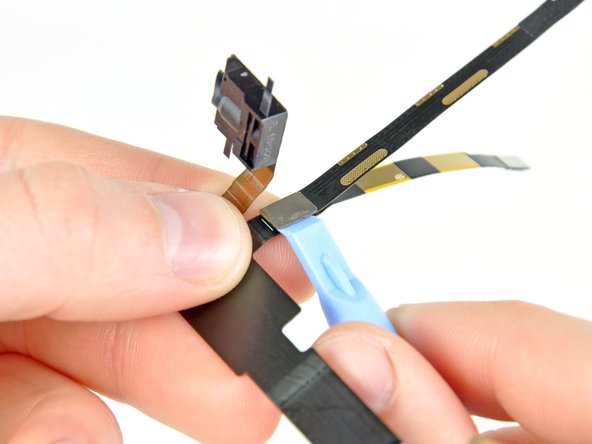

Add Note Edit Step 35  ¶
  • Use the edge of a plastic opening tool to disconnect the front camera cable from the headphone jack cable.

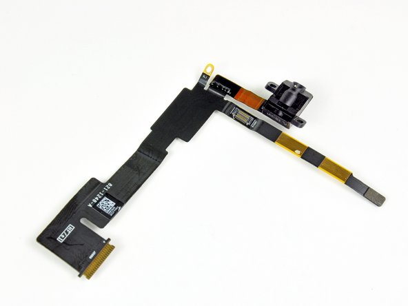

Add Note Edit Step 36 — Headphone Jack  ¶
  • Headphone jack remains.
