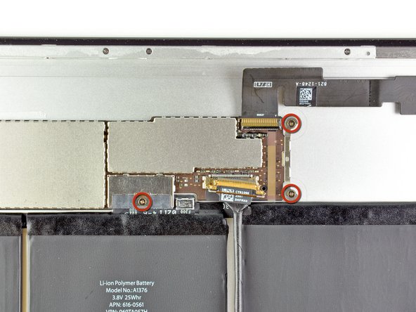

Add Note Edit Step 41  ¶
  • Remove the remaining three 2.6 mm Phillips screws securing the logic board to the rear case.

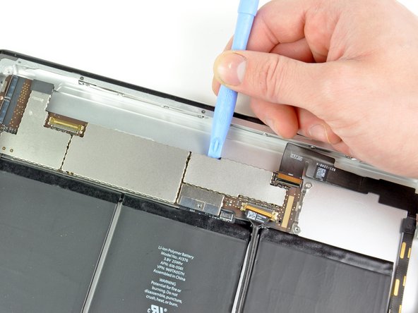

Add Note Edit Step 42  ¶
  • Use the edge of a plastic opening tool to gently pry the logic board up from the adhesive securing it to the rear case.

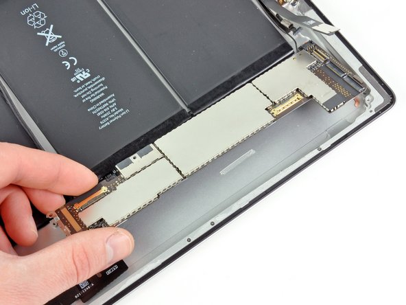

Add Note Edit Step 43  ¶
  • Lift the logic board out from the rear case and tilt it slightly toward the battery.
  • Do not try to completely remove it just yet. There is still an antenna cable attached to it.

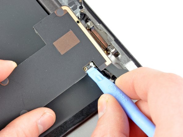

Image #1
Add Note Edit Step 44  ¶
  • Use the edge of a plastic opening tool to pry the Wi-Fi antenna connector up from its socket on the logic board.
  • Remove the logic board from the iPad 2.

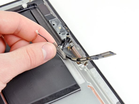

Image #1
Add Note Edit Step 45 — Bluetooth/Wi-Fi Antenna  ¶
  • Move the dock connector/speaker cables out of the way and peel the Bluetooth/Wi-Fi antenna cable off the adhesive securing it to the rear case.

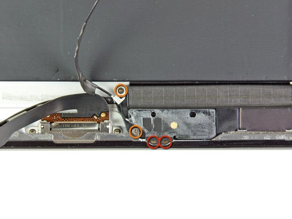

Image #1
Add Note Edit Step 47  ¶
  • Peel the Bluetooth/Wi-Fi antenna off the speaker enclosure and remove it from the iPad 2.
