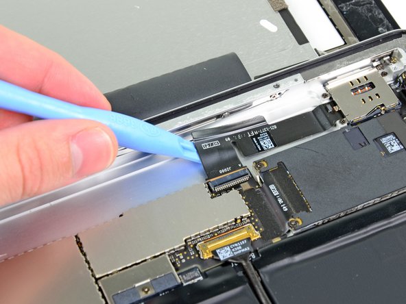

Add Note Edit Step 1 — Headphone Jack Assembly  ¶

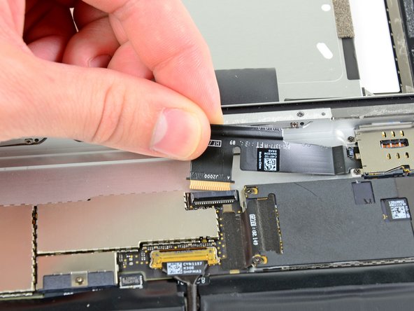

  • Use the flat end of a plastic opening tool to flip up the retaining flap on the headphone jack and front-facing camera ribbon cable ZIF socket.
  • Run a plastic opening tool underneath the headphone jack and front-facing camera cable to free it from the adhesive attaching the cable to the rear panel.
  • Pull the headphone jack and front-facing camera ribbon cable straight out of its socket on the logic board.

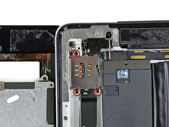

Add Note Edit Step 2  ¶
  • Remove the three 2 mm Phillips screws securing the SIM slot to the rear panel.

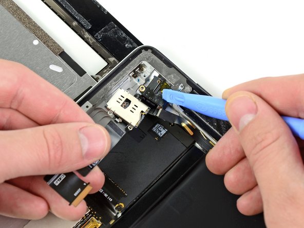

Add Note Edit Step 4  ¶
  • Use a plastic opening tool to help pull the headphone jack away from its recess in the top edge of the iPad.
  • Don't try to remove the assembly just yet.

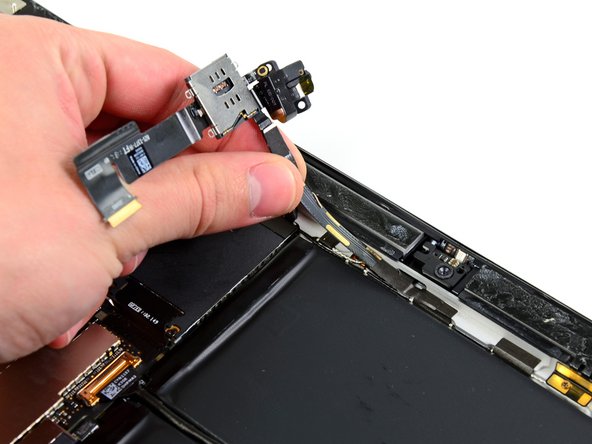

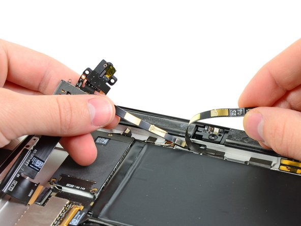

Add Note Edit Step 5  ¶
  • Carefully peel the front camera and microphone cables off the rear panel.
Image #1 Image #2

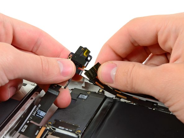

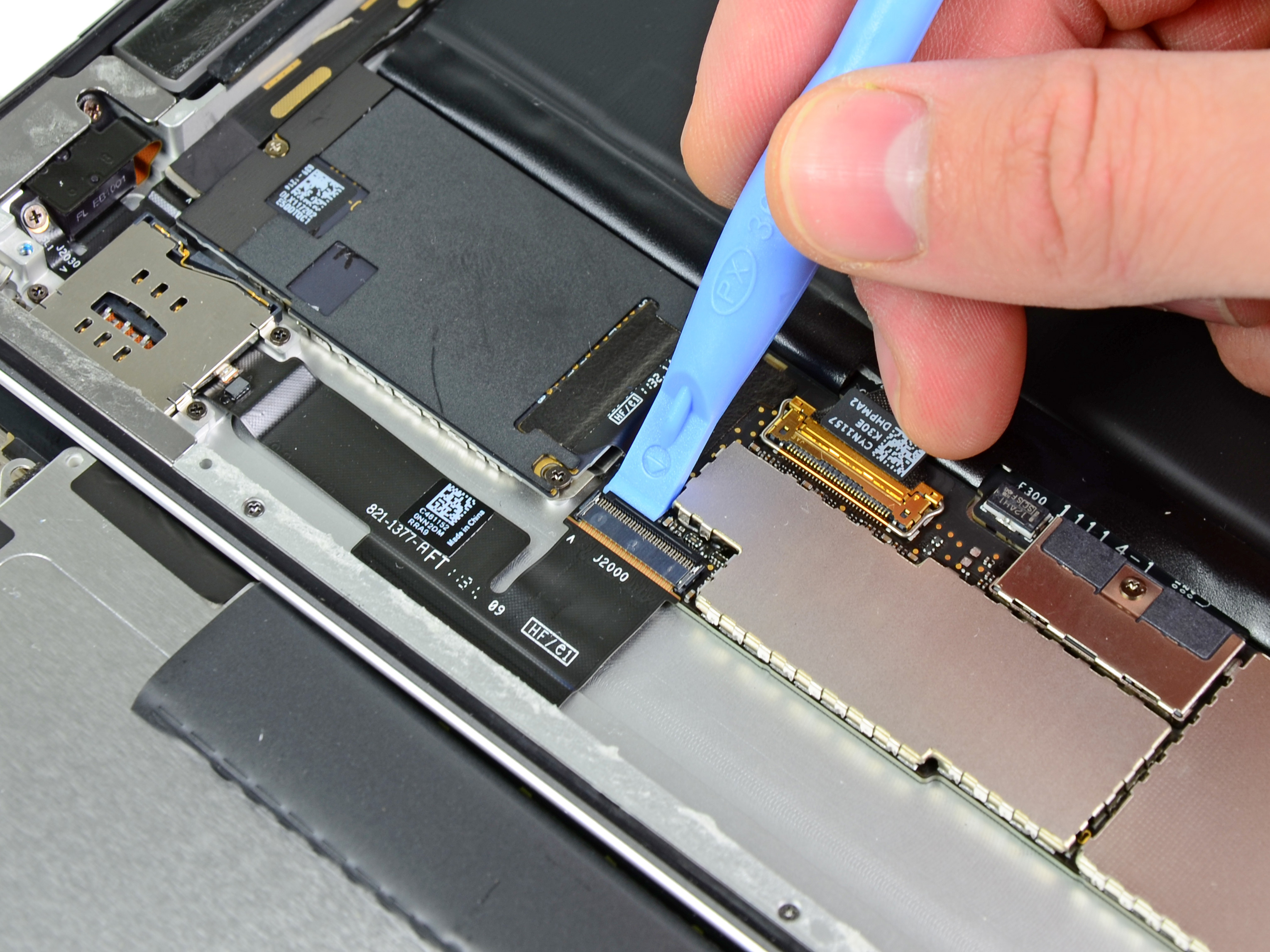

Add Note Edit Step 6  ¶
  • Carefully remove the strip of tape covering the front camera cable connector.
  • Use the edge of a plastic opening tool to disconnect the front camera cable from the headphone jack cable.
Image #1

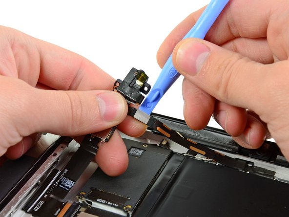

Add Note Edit Step 7  ¶
  • Carefully peel the front camera cable off the bottom ribbon cable attached to the headphone jack.
