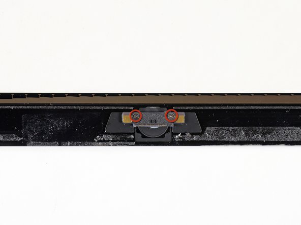

Add Note Edit Step 32 — Home Button Control Board  ¶
  • Remove the two 2.1 mm Phillips #00 screws securing the home button control board to the home button assembly.

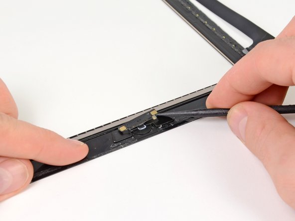

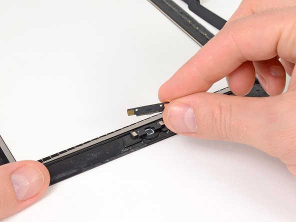

Add Note Edit Step 33  ¶
  • Use the tip of a spudger to gently push the home button control board off its mounts on the front panel.
  • Lift and remove the home button control board away from the front panel assembly.
