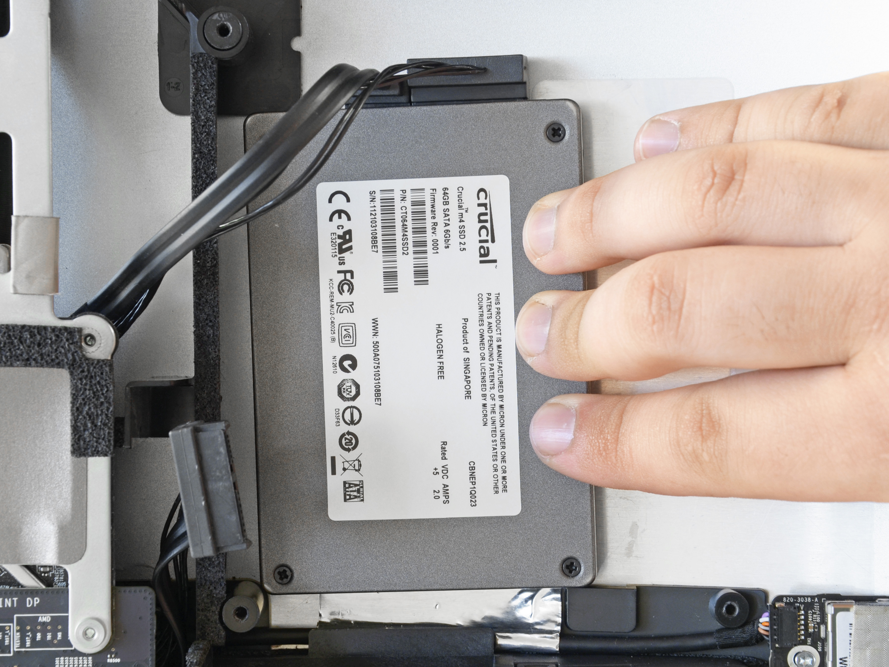

Image #1 Image #2 Image #3
Add Note Edit Step 35  ¶
  • Connect both the SATA data and SATA power connectors to their respective sockets on the SSD.
  • Peel the backing off of the double sided tape.
  • Carefully set the SSD into the iMac optical bay as close to the lower left corner as possible.
  • Do not to repeatedly stick and un-stick the tape, as the adhesive will become weaker.
  • Once you are happy with the SSD's placement, firmly press down along its edges to ensure full adhesion.
  • When re-installing the optical drive, the SATA cable will be sandwiched between the foam padding and the optical drive.
