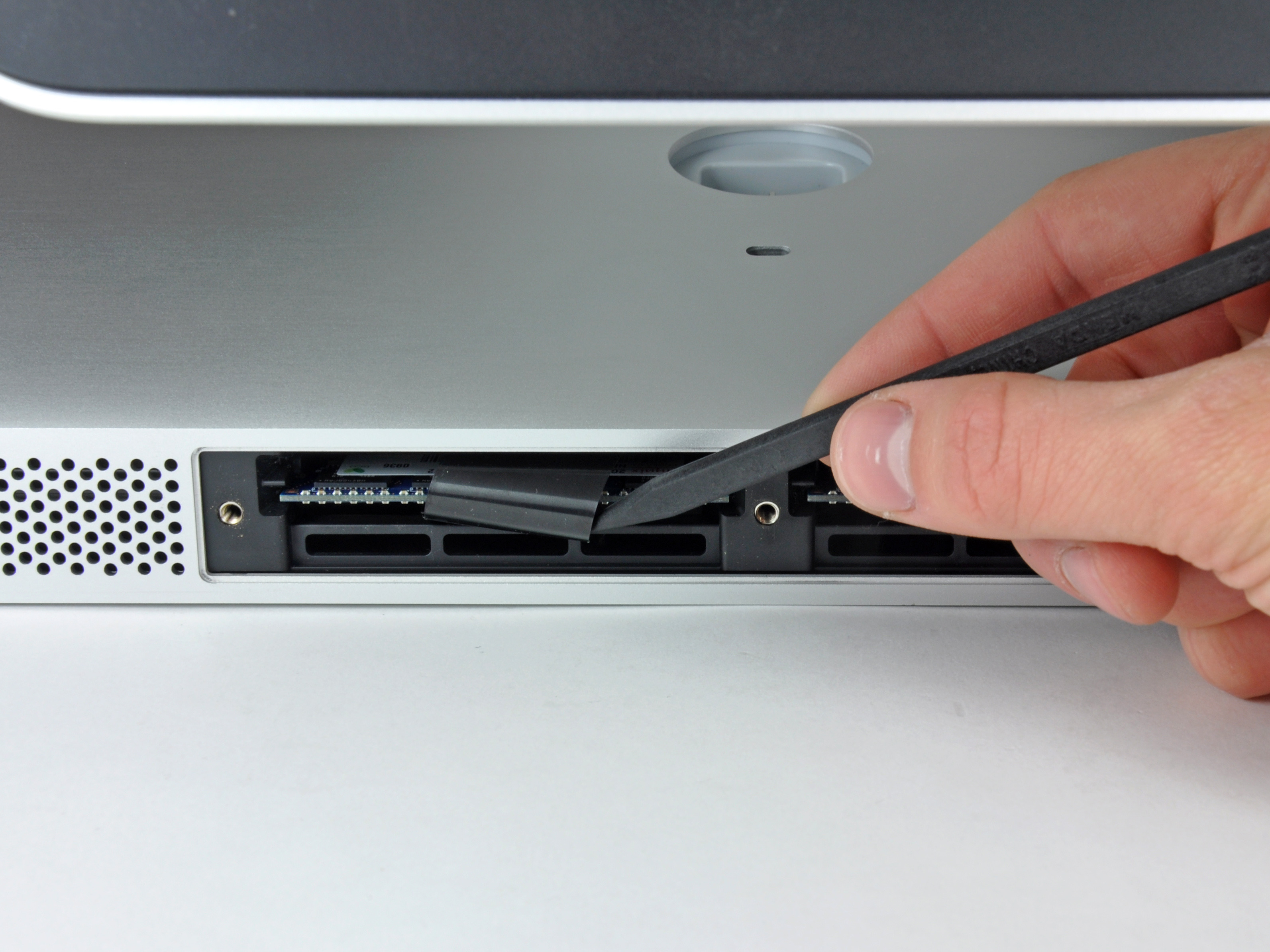

  2. iMac Intel 27" EMC 2309 and 2374 RAM Replacement, RAM: step 2, image 1 of 1
    • Use your fingers or the tip of a spudger to slide the black plastic RAM tray pull tab out of the RAM slot.
  3. iMac Intel 27" EMC 2309 and 2374 RAM Replacement: step 3, image 1 of 2 iMac Intel 27" EMC 2309 and 2374 RAM Replacement: step 3, image 2 of 2
    • Pull the black plastic tab away from the iMac to eject the RAM chip from its socket.
    • The RAM modules are firmly seated and may require a fair amount of force to remove.
    • Use your fingers to slide the RAM chip out of its socket.
    • If necessary, repeat this process for the other RAM module(s).
