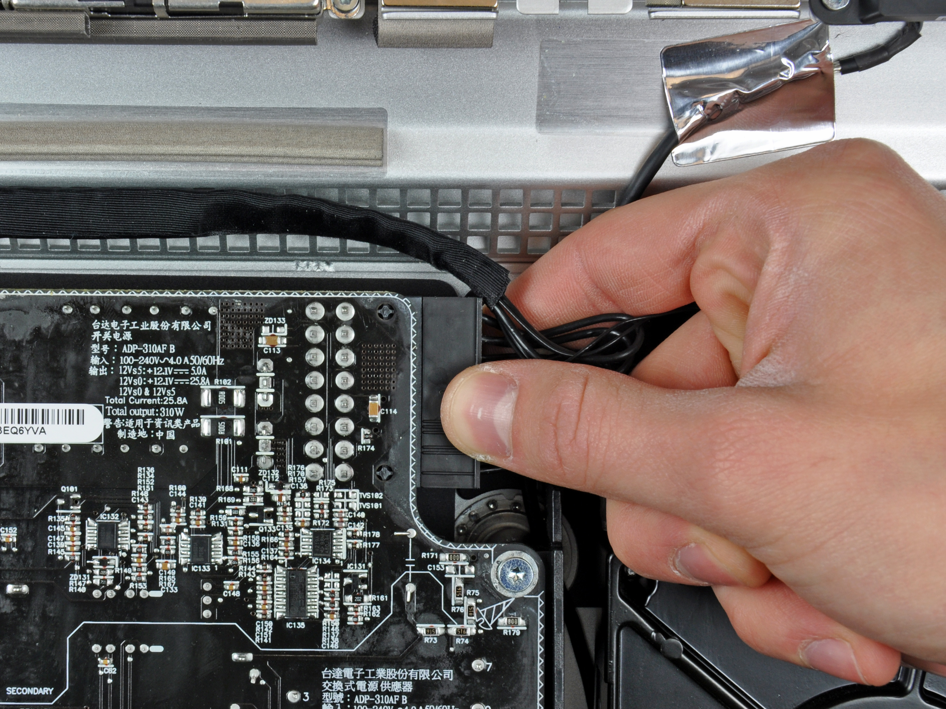

  10. iMac Intel 27" EMC 2309 and 2374 Power Supply Replacement, Power Supply: step 10, image 1 of 2 iMac Intel 27" EMC 2309 and 2374 Power Supply Replacement, Power Supply: step 10, image 2 of 2
    • The next few steps bring your hands close to the exposed face of the power supply. To avoid a high voltage shock from the many large capacitors attached to the board, do not touch the face of the power supply.
    • Disconnect the DC power cable by using your index finger to depress the locking mechanism on the back of the connector while you pull the connector away from its socket on the power supply.
    • Once the locking mechanism has cleared the socket, pull the DC power connector away from the power supply.
