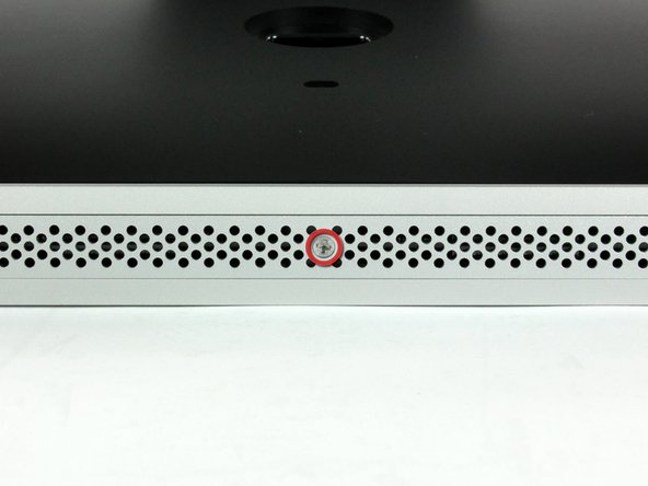

  • Lay your iMac front side down on a table with the lower edge facing yourself.
  • Loosen the single Phillips screw PH#2 in the center of the access door.
  • This screw is captive in the access door.
  • Remove the access door from your iMac.

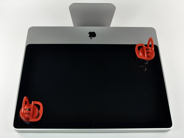

Add Note Edit Step 2 — Glass Panel — Note - most of this guide was taken from the info for: iMac Intel 20" EMC 2266  ¶

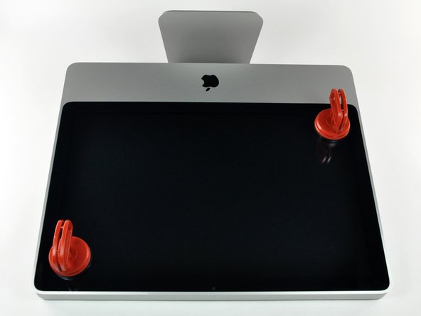

  • The glass panel is fixed onto the front bezel with fourteen magnets around its perimeter.
  • Stick two suction cups to opposing corners of the glass panel. Small suction cups used to stick things to windows or shower walls work.
  • To attach the suction cups we sell, first position the suction cup with the movable handle parallel to the face of the glass panel. While lightly holding the suction cup against the glass, raise the movable handle until it is parallel with the other handle.
  • If your suction cups refuse to stick, try cleaning both the glass panel and the suction cup with a mild solvent.

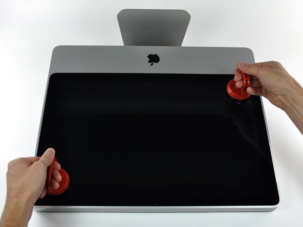

  • Gently pull the glass panel straight up off the iMac.
  • The glass panel has several positioning pins around its perimeter. To avoid bending or shearing these pins off the glass panel, be sure to only pull straight up during removal.
  • Be meticulous about cleaning the LCD and the inside face of the glass panel before reinstallation, as any fingerprints or dust trapped inside will be annoyingly visible when the display is on.

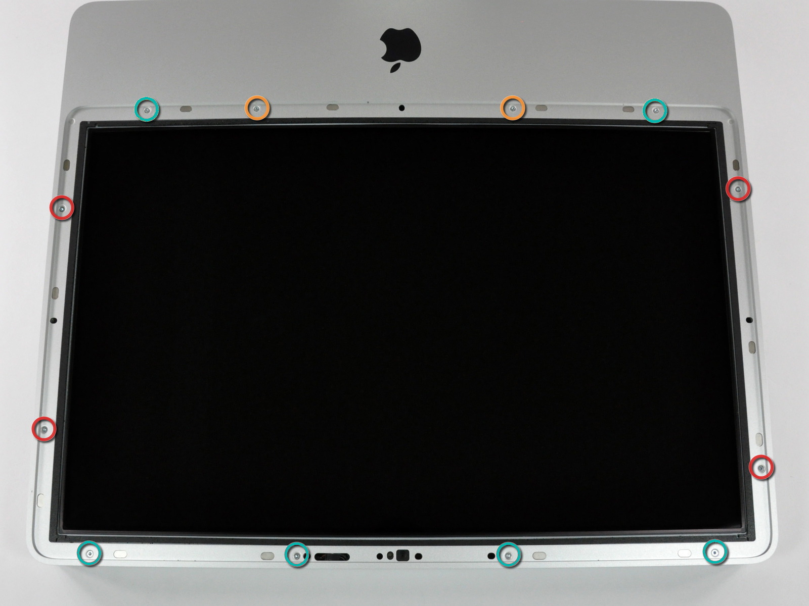

  • Remove the following 12 screws securing the front bezel to the rear case:
    • bottom centre two are long (26mm)
    • four on sides (two left, two right) are medium (18mm)
    • and the remaining six (four top, two bottom corners) are short (14mm).

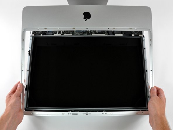

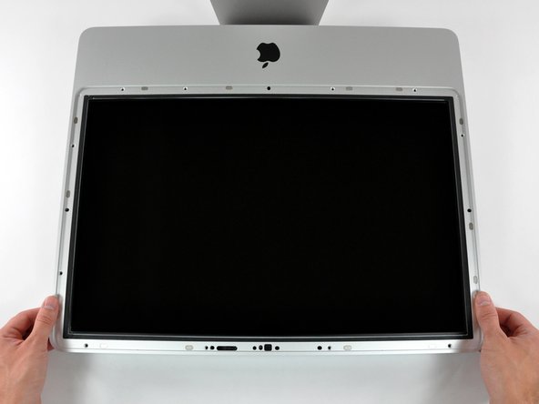

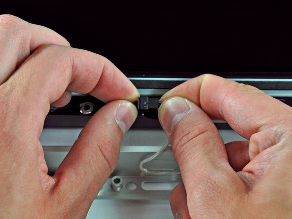

  • The front bezel is still attached to the iMac by the microphone cable.
  • Gently lift the front bezel from its top edge off the rear case.
  • Once the top edge of the front bezel has cleared the rear case, rotate the front bezel toward the stand and lift it off the rear case.
  • Rotate the front bezel away from the rest of the device and lay it above the top edge of the iMac.
  • When reinstalling the front bezel, start at the lower edge and make sure it is flush with the rear case before lowering the top edge onto the iMac.
Image #1
Add Note Edit Step 6  ¶
  • There is enough length in the microphone cable so that the bezel can be laid on the table above the computer without needing to be disconnected.
  • Disconnect the microphone cable connector, removing tape as necessary.
  • For the front bezel to sit properly, be sure to tuck the microphone cable and connector into the void next to the camera board.
