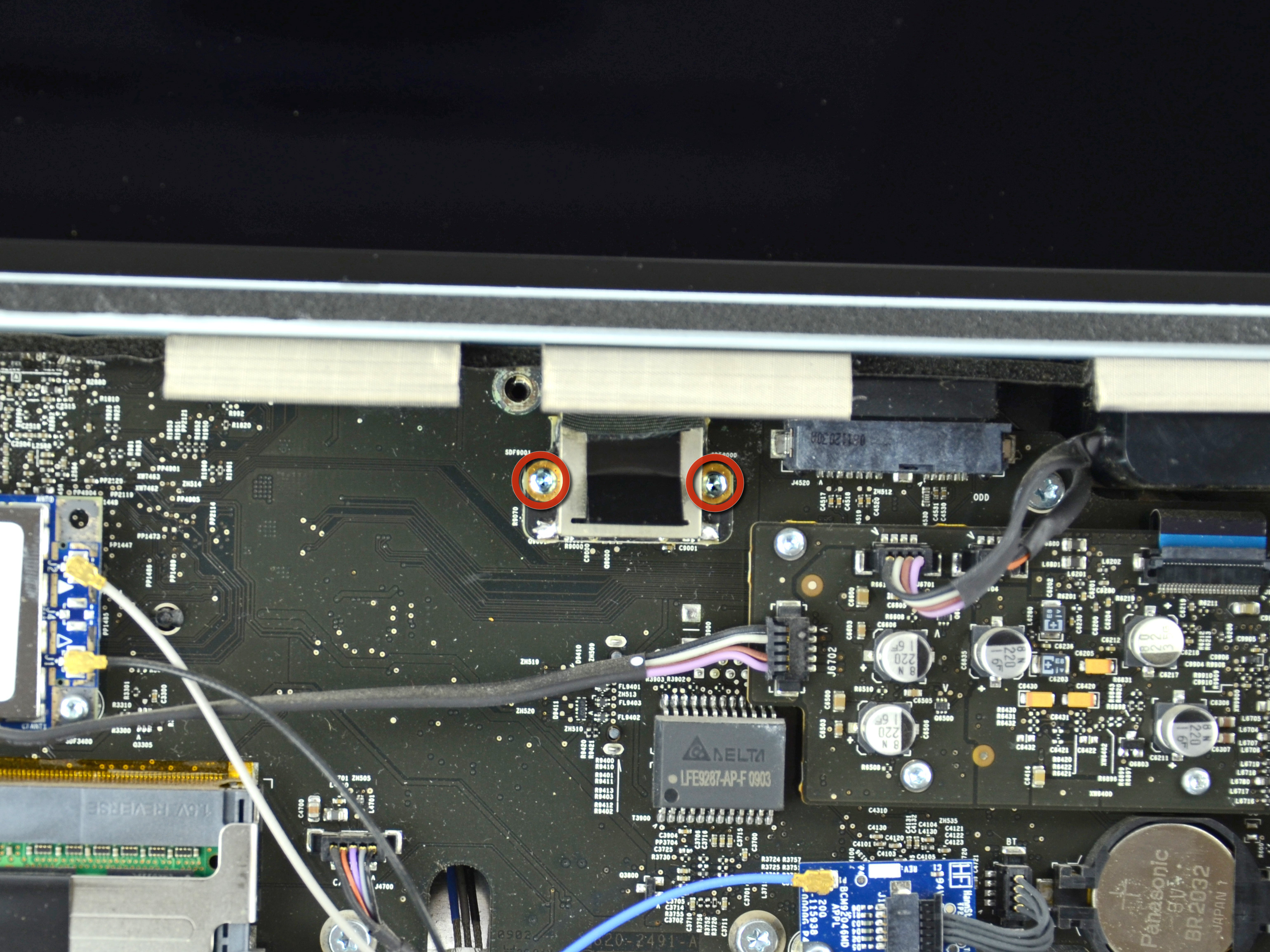

Add Note Edit Step 7 — Display Panel  ¶
  • Remove the two 5.3 mm T6 torx screws from the LCD connector.
  • Firmly grasp the pull tab on top of the connector and pull it straight up out of its port.
    • Make sure that you are pulling the tab and not the connector cable.
