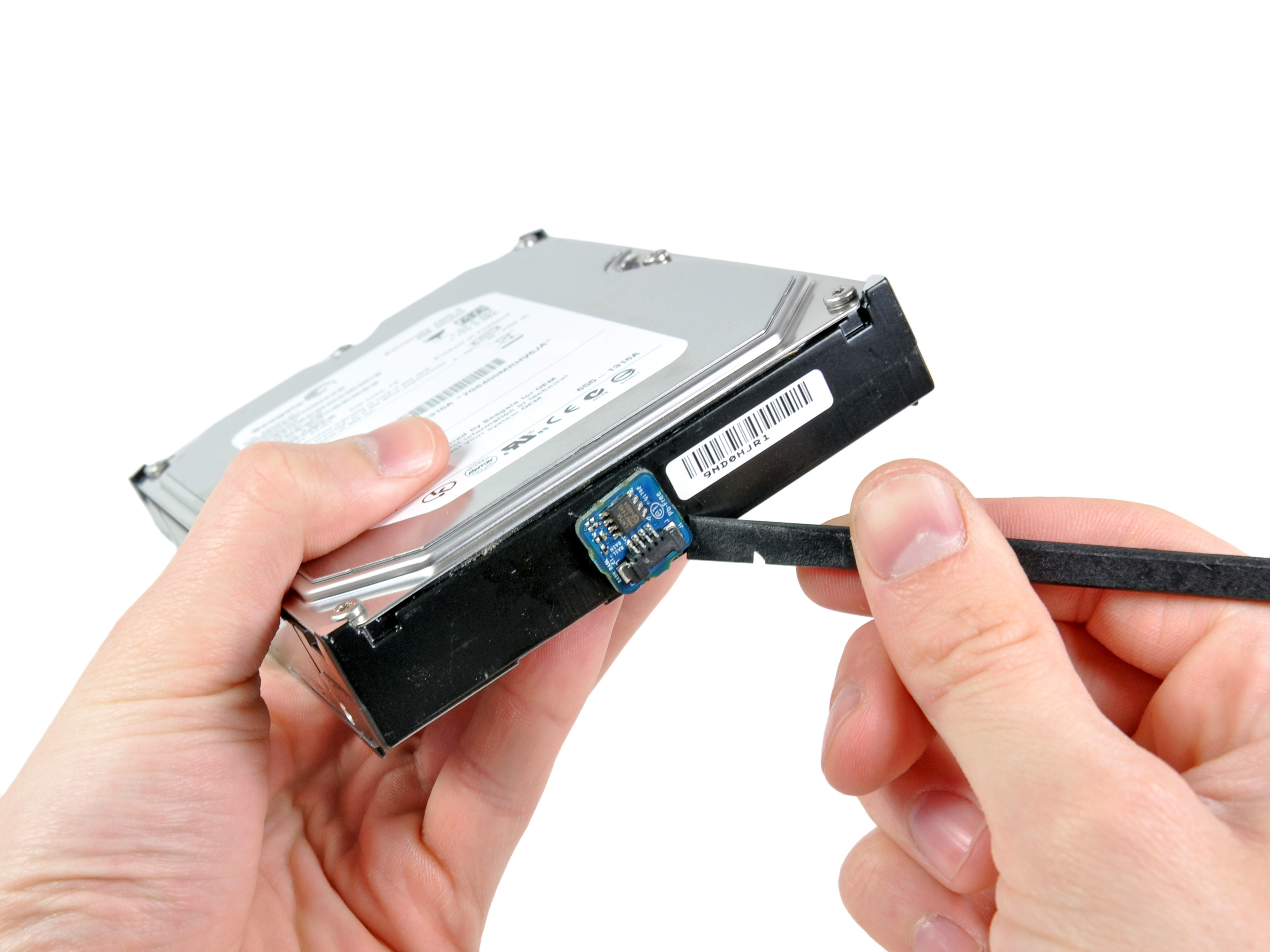

Add Note Edit Step 17 — Hard Drive Replacement  ¶
  • Remove the two T8 Torx screws securing the hard drive bracket to the side of the hard drive.
  • Remove the hard drive bracket.
Image #1
Add Note Edit Step 18  ¶
  • Remove the two T8 Torx retaining posts from the other side of the hard drive.
Image #1
Add Note Edit Step 19  ¶
  • Use the flat end of a spudger to remove the thermal sensor from the side of the hard drive.
  • Hard drive remains.
