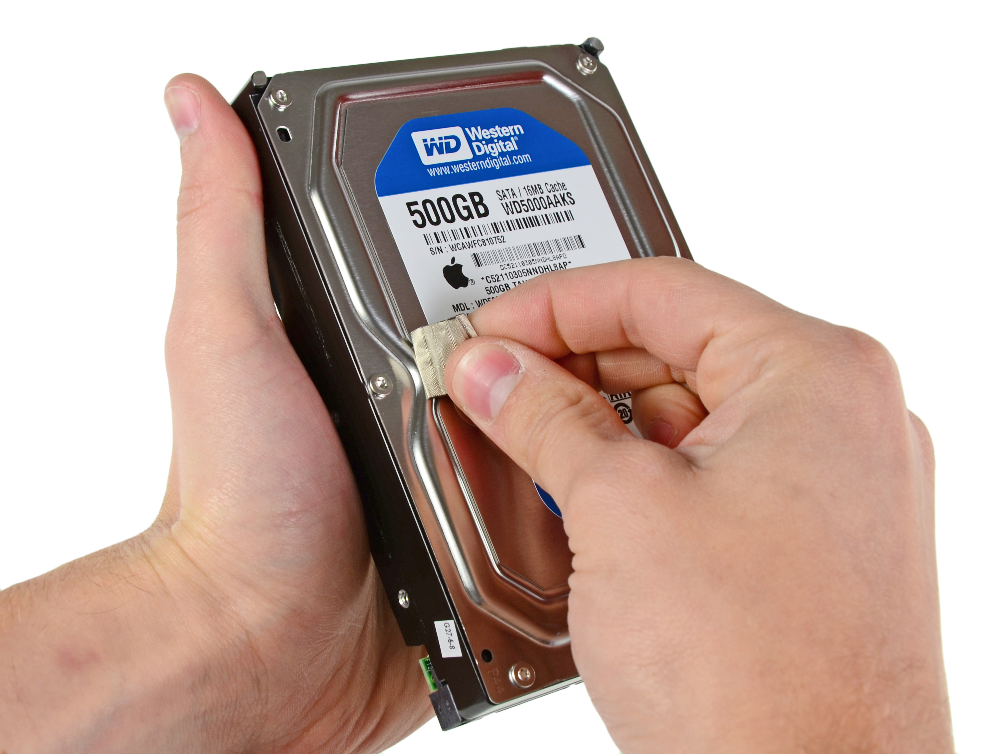

  12. iMac Intel 21.5" EMC 2428 Hard Drive Replacement: step 12, image 1 of 2 iMac Intel 21.5" EMC 2428 Hard Drive Replacement: step 12, image 2 of 2
    • Disconnect the SATA data cable and SATA power connector from their respective sockets by pulling each connector away from the hard drive.
  13. iMac Intel 21.5" EMC 2428 Hard Drive Replacement, Hard Drive: step 13, image 1 of 1
    • Remove the two T8 Torx screws securing the upper bracket to the hard drive.
    • Remove the upper bracket from the hard drive.
  14. iMac Intel 21.5" EMC 2428 Hard Drive Replacement: step 14, image 1 of 1
    • Remove the two T8 Torx pins from the other side of the hard drive.
  15. iMac Intel 21.5" EMC 2428 Hard Drive Replacement: step 15, image 1 of 1
    • Carefully peel off the piece of EMI foam attached to the front of the hard drive.
    • Don't forget to transfer this to your new hard drive.
