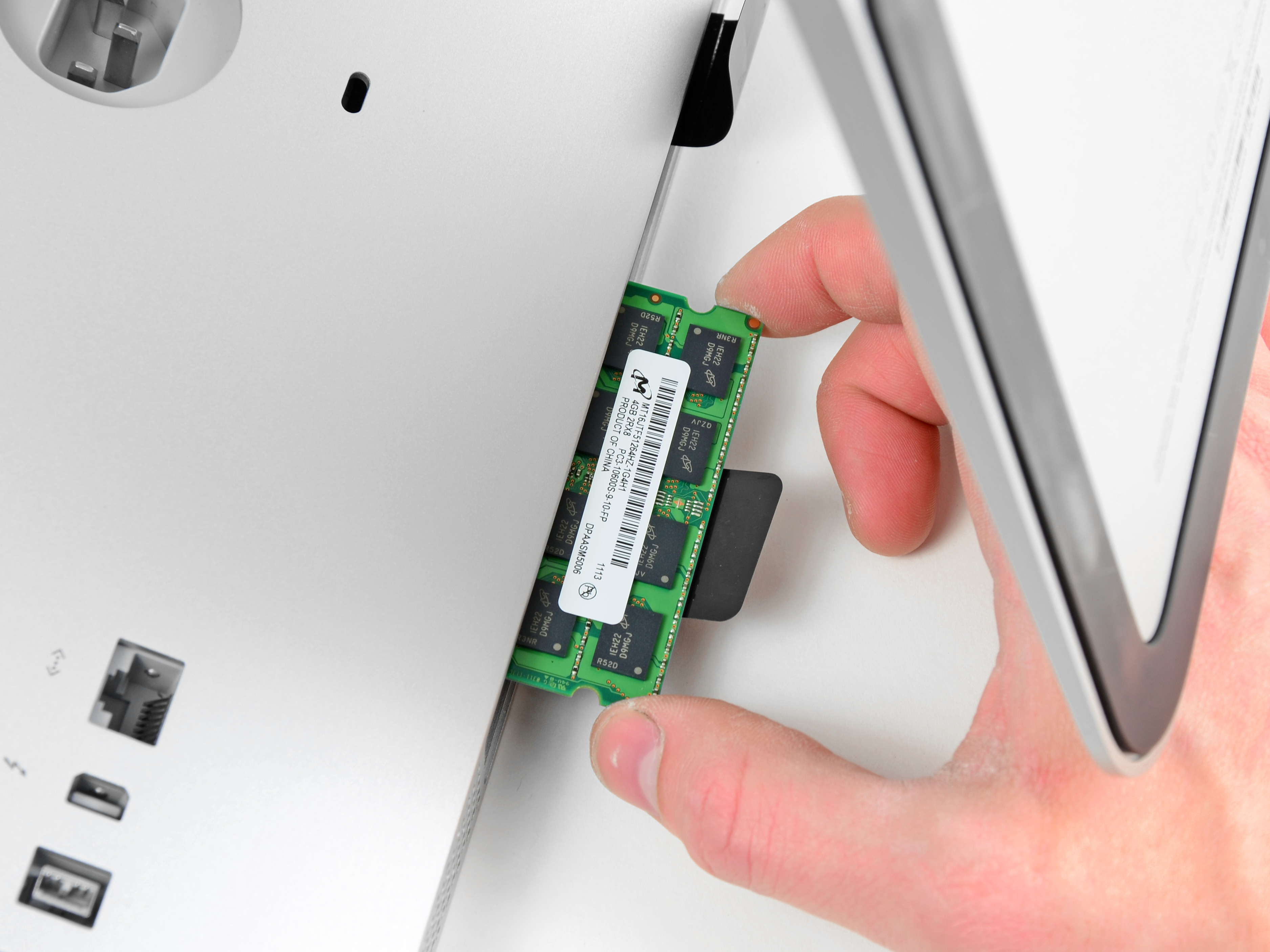

  3. iMac Intel 21.5" EMC 2389 RAM Replacement: step 3, image 1 of 1
    • Slide the old RAM module(s) out of their slots in the RAM bay and set them aside.

  5. iMac Intel 21.5" EMC 2389 RAM Replacement: step 5, image 1 of 3 iMac Intel 21.5" EMC 2389 RAM Replacement: step 5, image 2 of 3 iMac Intel 21.5" EMC 2389 RAM Replacement: step 5, image 3 of 3
    • When installing new RAM modules, it is important to orient them correctly.
    • Be sure the small notch cut into each RAM module (shown in the first picture) mates with the protrusion in each RAM slot (shown in the second picture).
    • Your iMac has four RAM slots. Be sure to slide each RAM module into its slot horizontally. This will prevent getting the modules stuck between two of the adjacent slots.
    • Once you have oriented the new RAM modules correctly, gently slide them completely into the iMac and use your thumbs to firmly seat them in their sockets.
