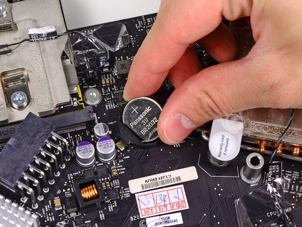

Add Note Edit Step 45 — PRAM Battery  ¶
  • Use the tip of a spudger to pry the PRAM battery out of its socket on the logic board.
  • The PRAM battery is a BR2032 lithium coin cell.
