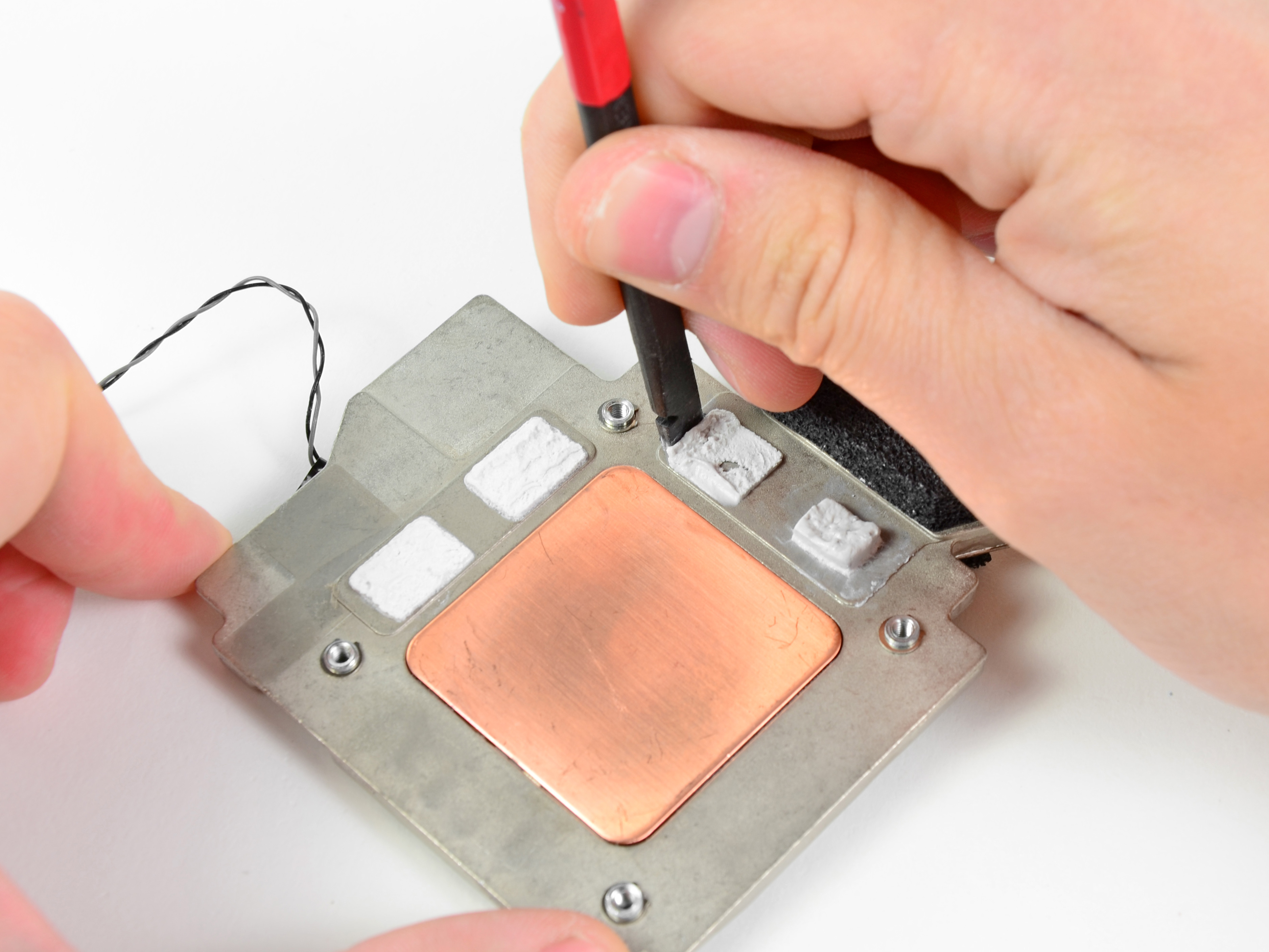

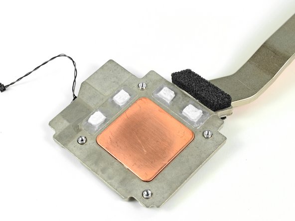

Image #1 Image #2 Image #3
Add Note Edit Step 51  ¶
  • Remove the GPU from the GPU heat sink.
  • Make sure to apply a new layer of thermal paste to the face of the GPU (the area boxed in red) before reattaching the heat sink. Our thermal paste guide makes it easy.
  • Before installing new thermal paste and mounting a new GPU to the GPU heat sink, use the flat end of a spudger to push the VRAM thermal goop closer together so it will better contact the VRAM when the GPU is installed.
