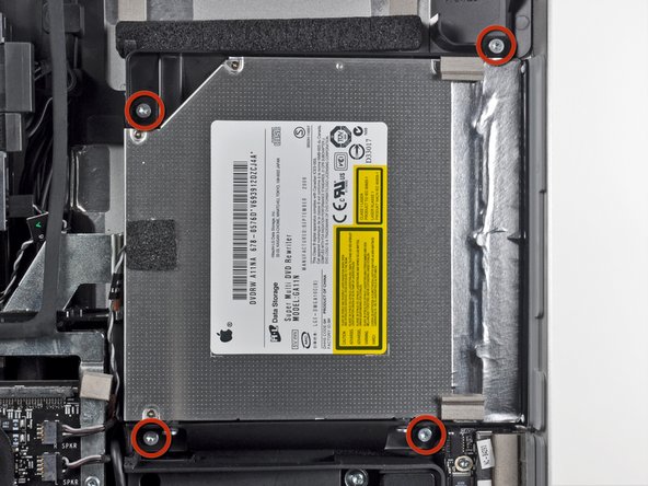

Add Note Edit Step 11  ¶
  • Remove the four 9 mm T10 Torx screws securing the optical drive to the outer case.

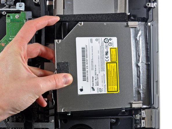

Add Note Edit Step 12  ¶
  • Lift the inner edge of the optical drive and maneuver its connector past the frame attached to the logic board.
  • Carefully pull the optical drive off its mounting pins on the edge of the outer case to gain clearance for disconnecting the optical drive cable.

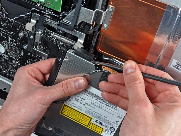

Add Note Edit Step 13  ¶
  • Use the flat end of a spudger to help disconnect the optical drive cable.

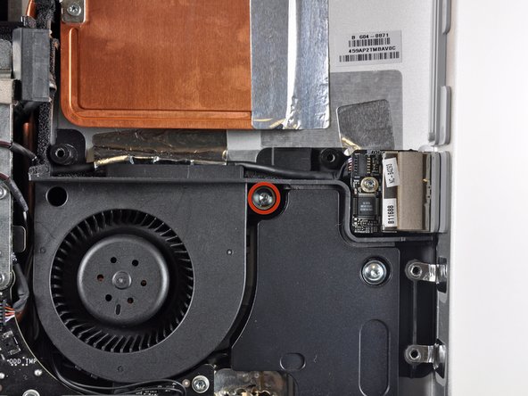

Add Note Edit Step 14 — Optical Drive Fan  ¶
  • Remove the single 13 mm T10 Torx screw securing the optical drive fan to the outer case.
Image #1

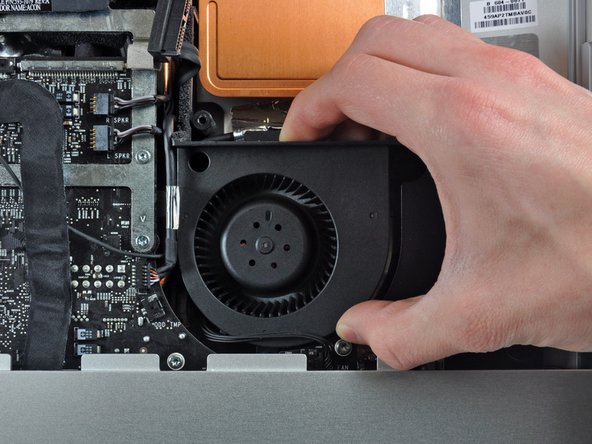

Add Note Edit Step 15  ¶
  • Pull the optical drive off the pins attached to the outer case.
Image #1

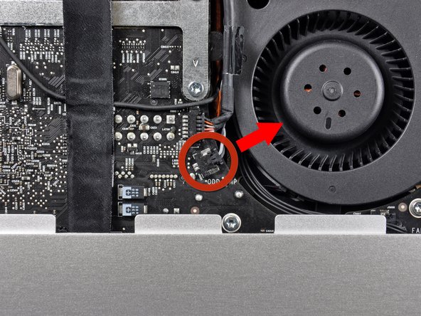

Add Note Edit Step 16  ¶
  • Pull the optical drive fan connector away from its socket on the logic board.
  • Remove the optical drive fan from the iMac.
