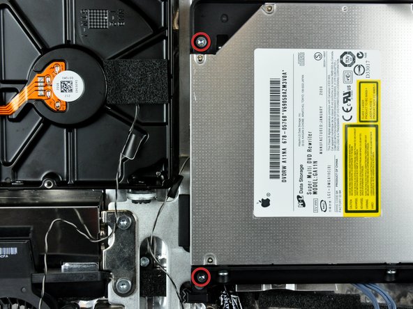

  • Remove the two T10 Torx screws securing the optical drive to the rear case.
Image #1 Image #2

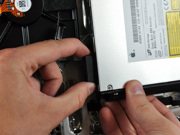

  • Lift the free end of the optical drive slightly.

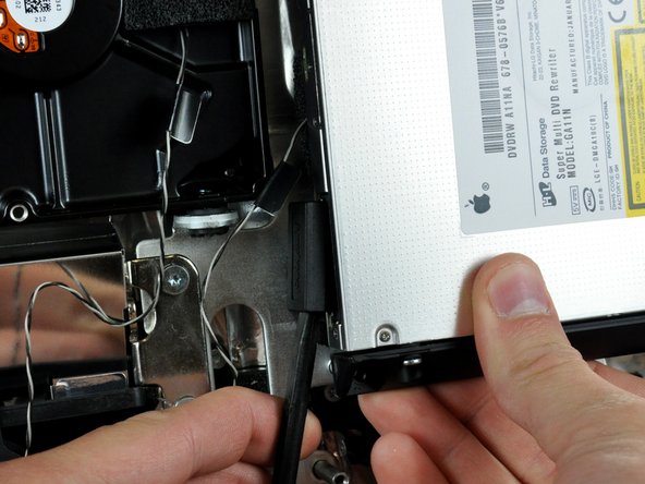

  • Insert a spudger between the optical drive connector and the optical drive.
  • Twist the spudger to slightly separate the optical drive connector from the optical drive, then use your fingers to pull the connector away from the drive.

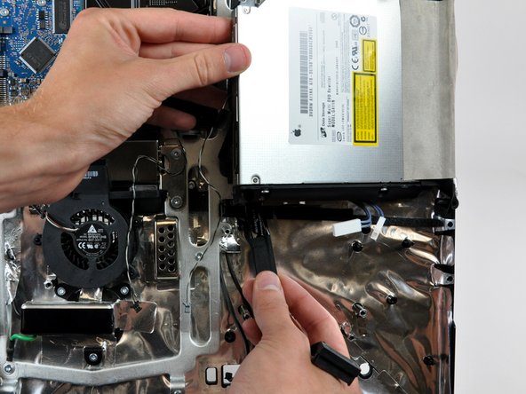

Image #1
Add Note Edit Step 19  ¶
  • Peel the optical drive data cable off the adhesive securing it to the rear case and remove it from your iMac.
