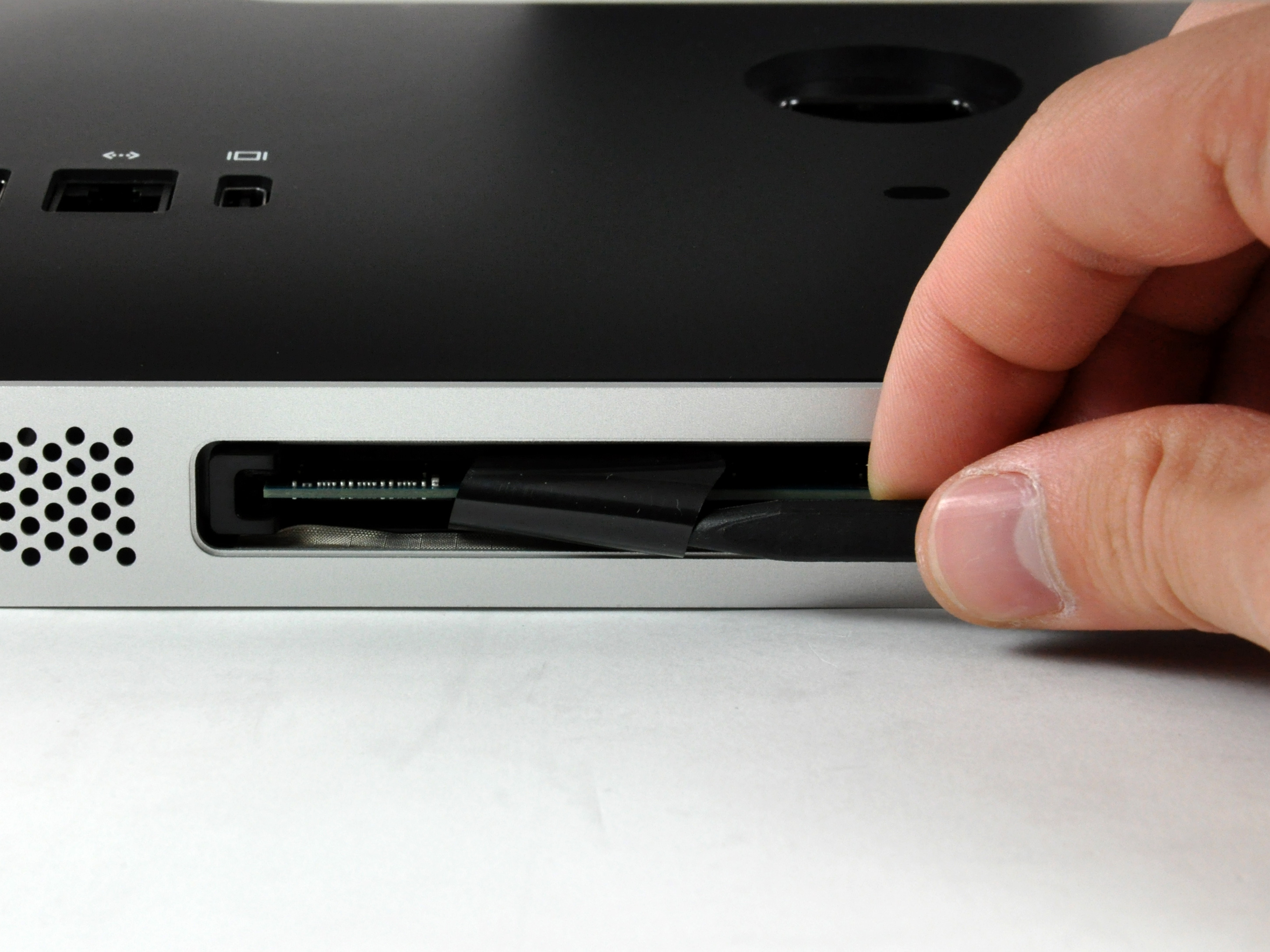

  2. iMac Intel 20" EMC 2133 and 2210 RAM Replacement, RAM: step 2, image 1 of 2 iMac Intel 20" EMC 2133 and 2210 RAM Replacement, RAM: step 2, image 2 of 2
    • Use the tip of a spudger to pull the black plastic RAM tabs out of the memory bay.
    • Pull the black plastic RAM tab away from your iMac to eject the RAM chip.
  3. iMac Intel 20" EMC 2133 and 2210 RAM Replacement: step 3, image 1 of 1
    • Grab the RAM chip by its edges and pull it straight out of its slot.
    • If two RAM chips are installed, repeat this process for the other chip.

I currently have a 4GB memory module installed on an EMC 2210 in one of the memory slots. Can I still install the original 1GB ram in the other slot making it 5GB total memory?
richt0812 - Reply
[|It depends on the model. Check here:] https://support.apple.com/en-us/HT201191
Alex Nos -
I installed 2GB x2 to mine to upgrade from 1GB x2. It took just minutes and I used a regular philips screw driver I found around home. Pull hard on the black straps to get the memory out. It is working great with no problems. Good luck!
1tom2go - Reply
Thank you for the guide. I had 2GB. I took out 1 module to add a 4GB module. So easy and now my 2133 iMac is jaw dropping fast.
Garison
garison - Reply
