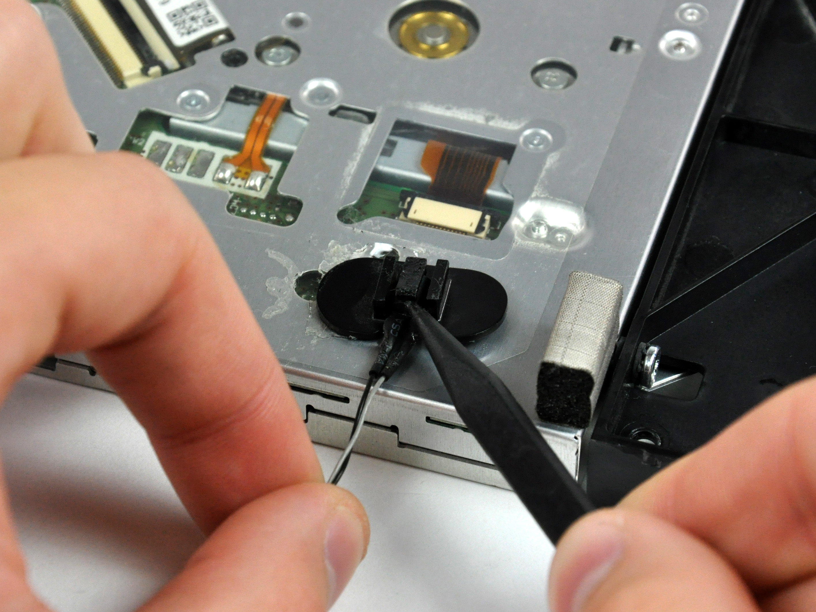

If necessary, remove the pieces of tape securing the hard drive/optical drive thermal sensor cables to your iMac.
To remove the optical drive thermal sensor, use the tip of a spudger to lift the center finger of the thermal sensor bracket while applying slight tension to the thermal sensor cable.
