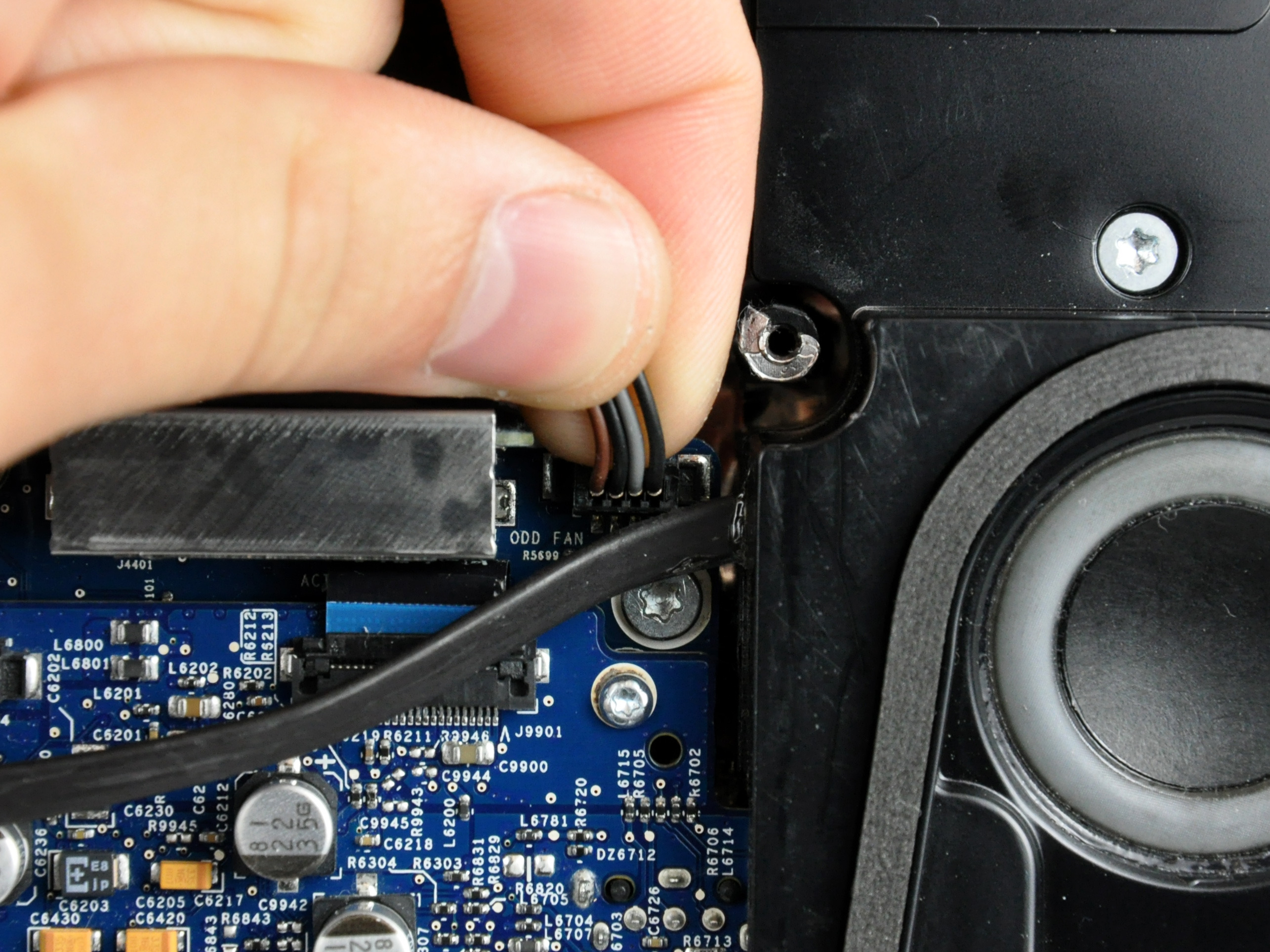

Add Note Edit Step 7 — Display Panel  ¶
  • Pull the LCD temperature sensor connector straight up out of its socket on the logic board.
  • If necessary, de-route the LCD temperature sensor cable from behind the logic board.
Image #1
Add Note Edit Step 8  ¶
  • Remove the two 5.3 mm T6 Torx screws securing the data display cable to the logic board.
