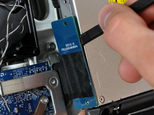

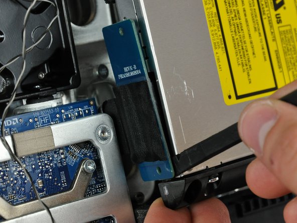

Add Note Edit Step 16  ¶
  • Insert the flat end of a spudger between the optical drive connector and the body of the optical drive.
  • Twist the spudger to separate the connector from the optical drive.
  • It may be necessary to work from alternating sides of the connector until it is disconnected.

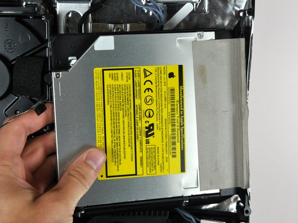

  • Lift the optical drive out of the rear case and pull it away from the side of the rear case to release the strip of EMI tape attached to its surface.
  • The optical drive thermal sensor is still attached to the underside of the optical drive.
Image #1

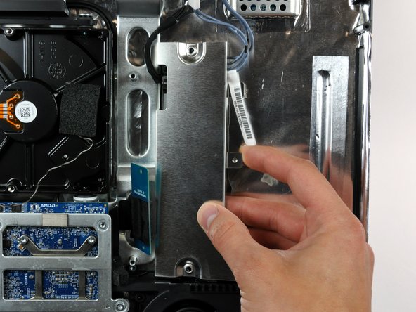

Add Note Edit Step 18 — Inverter  ¶
  • Remove the two 13 mm T10 Torx screws securing the inverter to the rear case.
Image #1
Add Note Edit Step 19  ¶
  • Pull the inverter away from the chassis and lift it slightly out of the rear case.

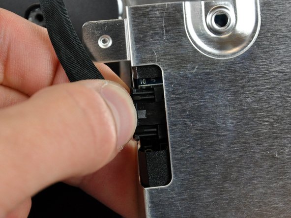

Add Note Edit Step 20  ¶
  • Disconnect the inverter cable by simultaneously squeezing the locking mechanism and pulling the connector away from its socket.
Image #1

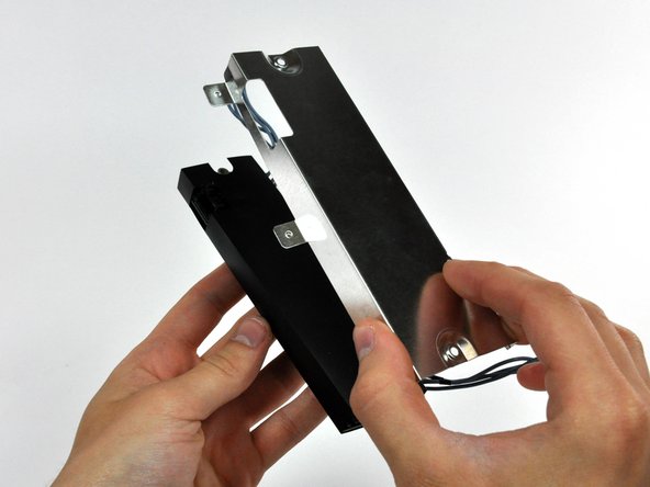

Add Note Edit Step 21  ¶
  • Lift the metal case off the inverter.
