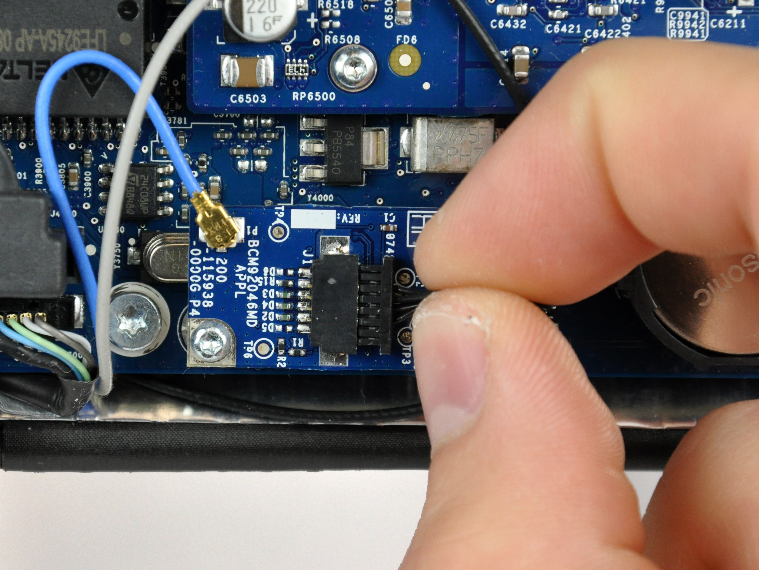

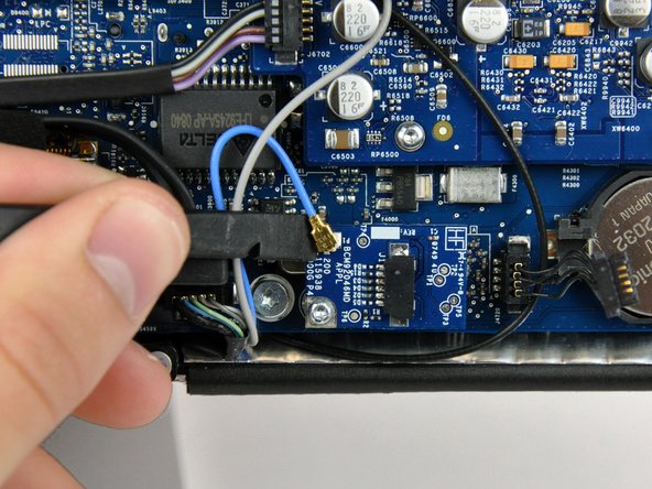

Add Note Edit Step 7 — Bluetooth Board  ¶
  • Pull the Bluetooth cable straight away from its socket.
  • Pull the connector parallel to the face of the Bluetooth board.
Image #1
Add Note Edit Step 8  ¶
  • Use the flat end of a spudger to pry the bluetooth antenna connector up off the bluetooth board.
