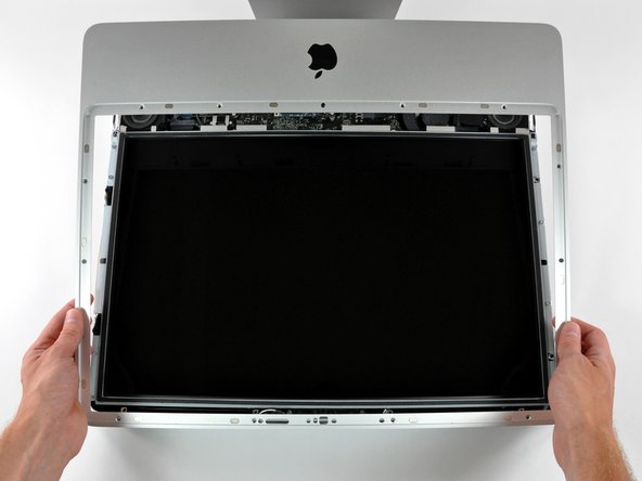

Add Note Edit Step 4 — Front Bezel  ¶
  • Remove the following 12 screws securing the front bezel to the rear case:
    • Eight 13 mm T8 Torx.
    • Four 25 mm T8 Torx.
Image #1 Image #2
Add Note Edit Step 5  ¶
  • The front bezel is still attached to the iMac by the microphone cable.
  • Gently lift the front bezel from its top edge off the rear case. It helps to use your thumbs to push down very gently on the corners of the display.
  • Once the top edge of the front bezel has cleared the rear case, rotate the front bezel toward the stand and lift it off the rear case.
  • When reinstalling the front bezel, start at the lower edge and make sure it is flush with the rear case before lowering the top edge onto the iMac.

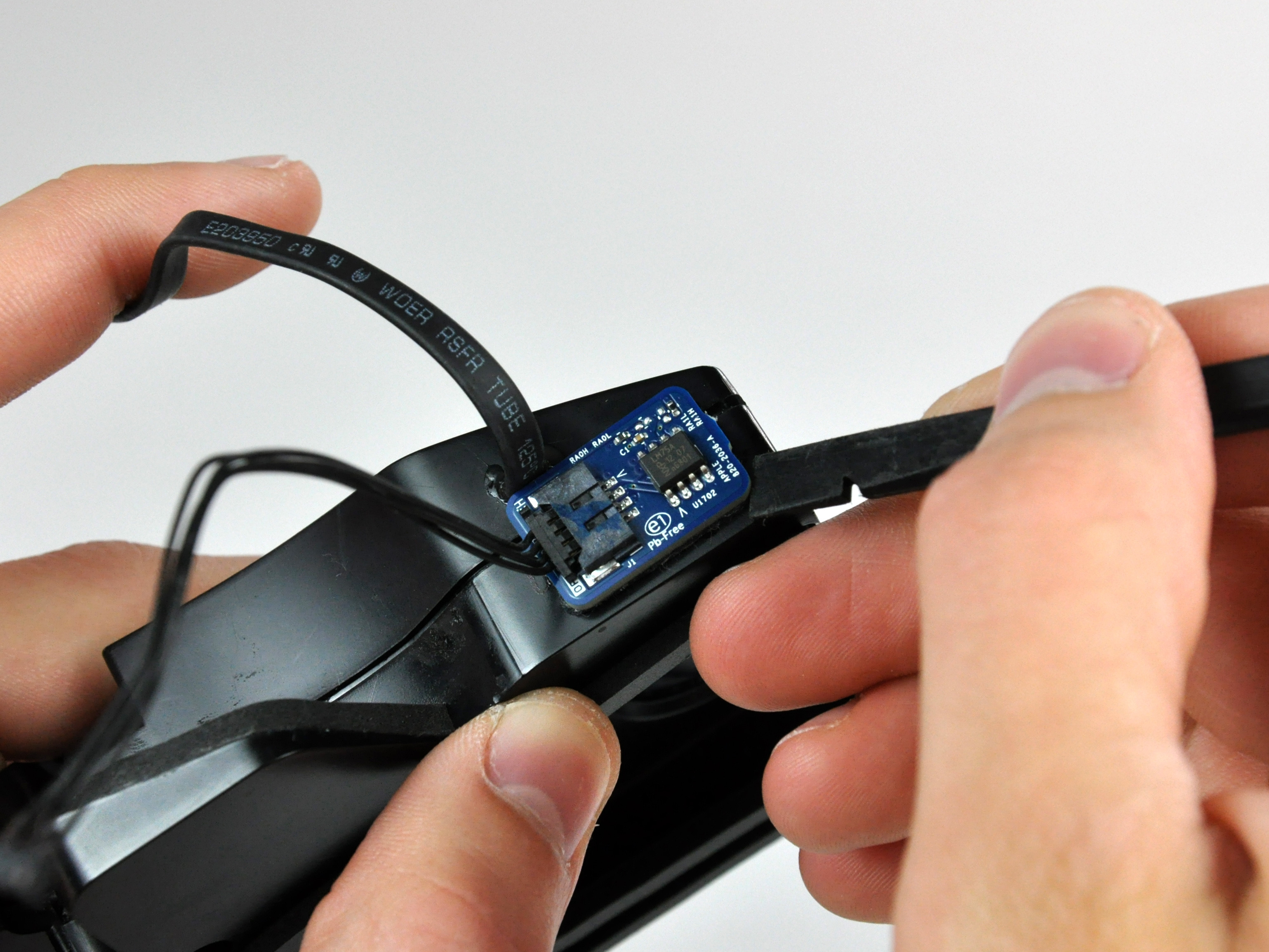

Add Note Edit Step 7 — Display Panel  ¶
  • Pull the LCD temperature sensor connector straight up out of its socket on the logic board.
  • If necessary, de-route the LCD temperature sensor cable from behind the logic board.
Image #1
Add Note Edit Step 8  ¶
  • Remove the two 5.3 mm T6 Torx screws securing the data display cable to the logic board.
