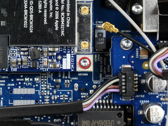

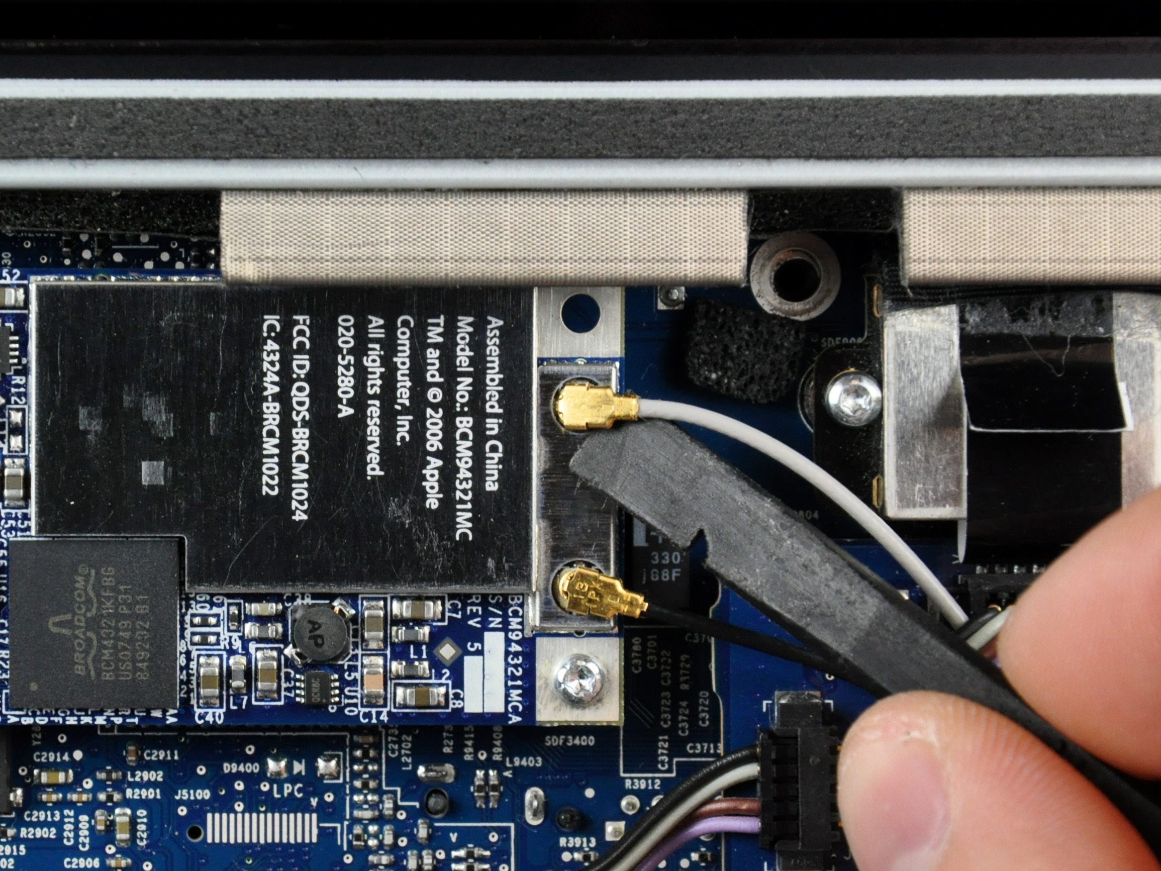

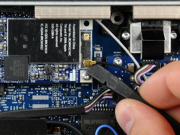

Add Note Edit Step 7 — AirPort Extreme  ¶
  • Use the flat end of a spudger to pry both antenna connectors up off the AirPort Extreme card.
Image #1
Add Note Edit Step 8  ¶
  • Remove the single 5.4 mm T6 Torx screw securing the AirPort Extreme card to the logic board.
  • The free end of the AirPort card should pop up slightly.
