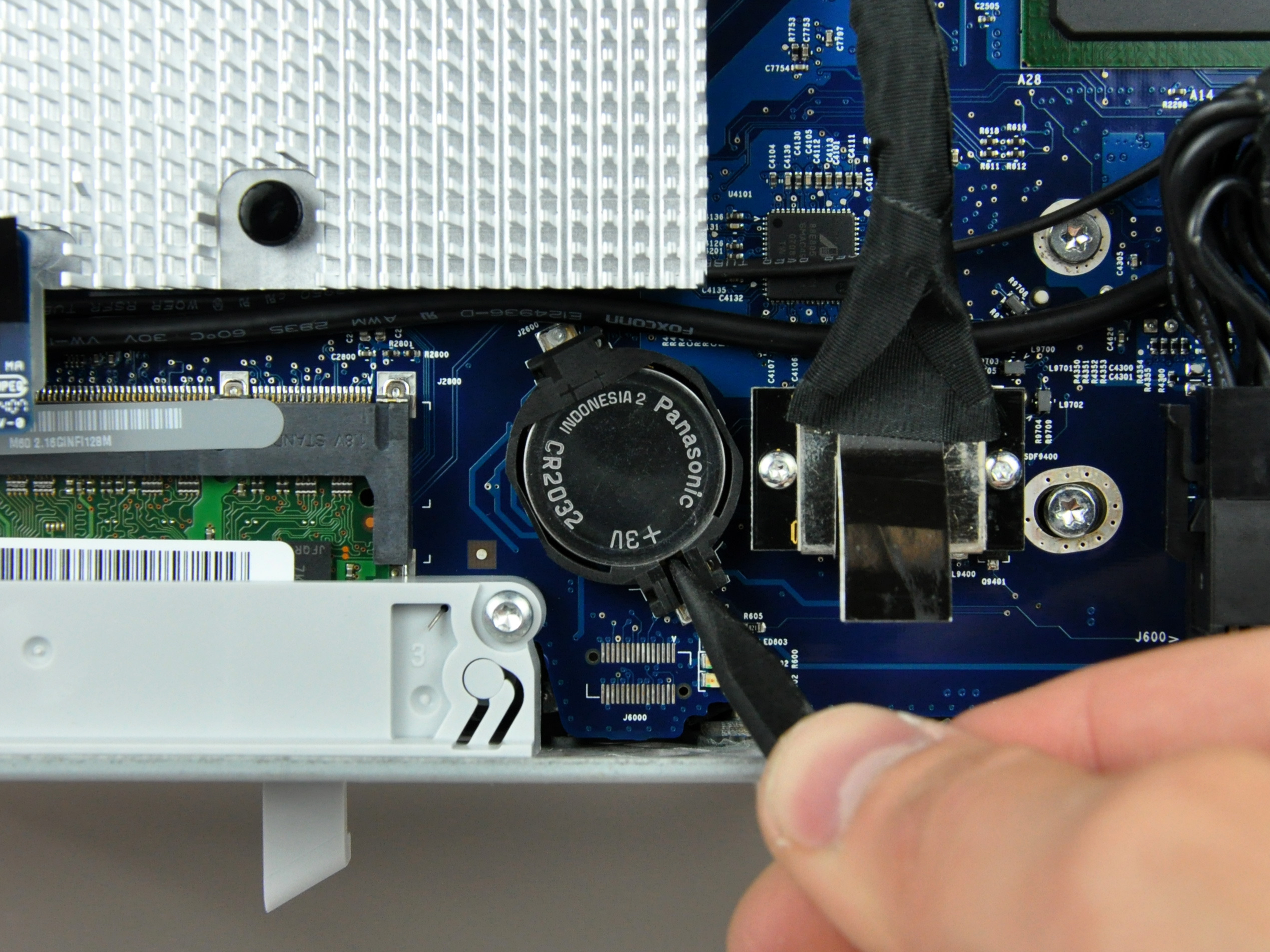

Add Note Edit Step 10 — PRAM Battery  ¶
  • Use the tip of a spudger to pry the PRAM battery out of its socket.
