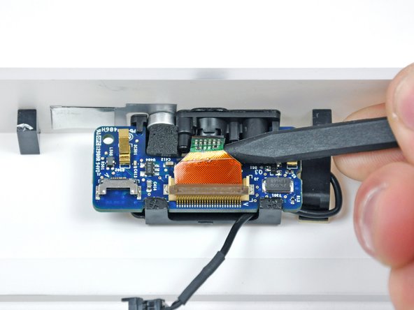

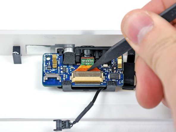

Add Note Edit Step 9  ¶
  • Use the tip of a spudger to flip up the camera ribbon cable retaining flap.
  • Flip the tab away from the front face of the front bezel.
  • Use the tip of a spudger to pull the camera ribbon cable away from its socket on the camera board.

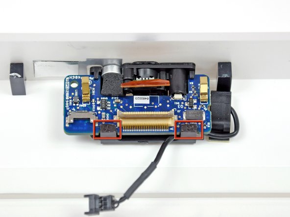

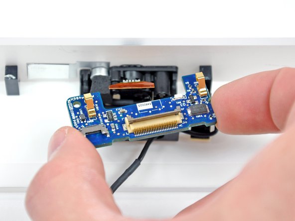

Add Note Edit Step 10  ¶
  • Rather than being held down by screws, the camera board is held down by a black plastic bracket attached to the front bezel.
  • In the next step, you will rotate the two black retaining clips (shown in red) away from the camera board to free it from the front bezel.
Image #1 Image #2

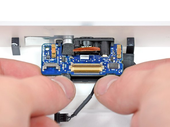

Add Note Edit Step 11  ¶
  • Use your thumbs to simultaneously rotate both retaining tabs away from the camera board while pushing the board up from either side with your index fingers.
  • Remove the camera board from the front bezel.

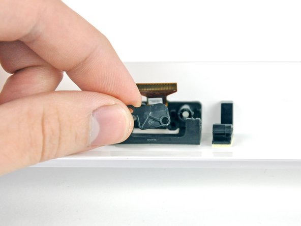

Image #1

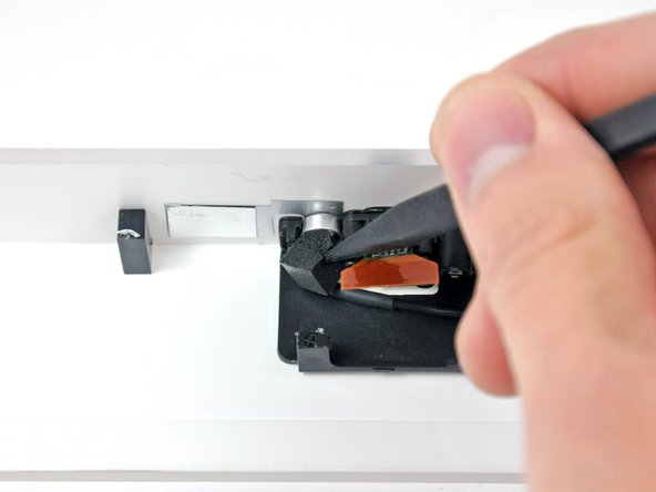

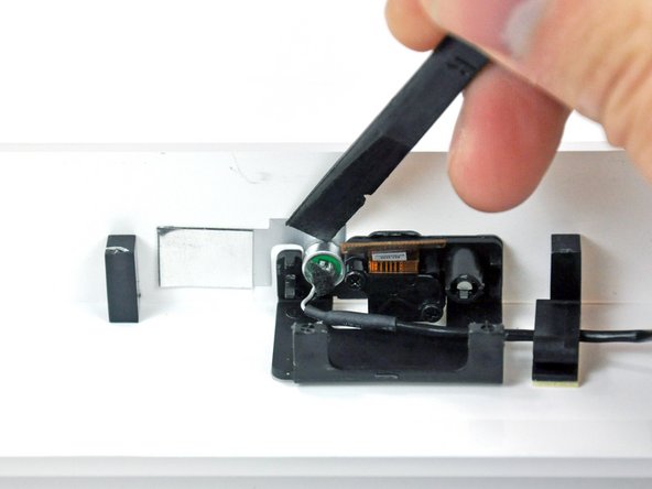

Add Note Edit Step 12 — Microphone  ¶
  • Use the tip of a spudger to remove the foam bumper covering the microphone.
Image #1
Add Note Edit Step 13  ¶
  • Use the flat end of a spudger to pry the microphone off the adhesive holding it to the front bezel.

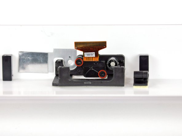

Image #1 Image #2
Add Note Edit Step 14 — Camera Lens  ¶
  • Remove the two Phillips screws securing the camera to the camera bracket.
  • Remove the small black plastic camera bracket from the front bezel.
Image #1

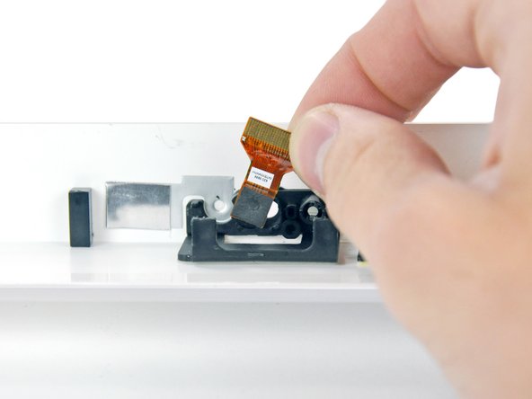

Add Note Edit Step 15  ¶
  • Pull the camera lens away from the camera bracket and remove it from the front bezel.
