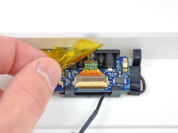

  • If necessary, remove the strip of tape covering the microphone cable connector.
  • The microphone connector is located near the inside of top edge of your iMac.
Image #1 Image #2 Image #3
Add Note Edit Step 7  ¶
  • Disconnect the microphone cable.
  • Disconnect the camera cable by pulling its connector away from the socket on the camera board.
  • The camera cable connector and socket are delicate and easily bent. Remove with caution.
Image #1

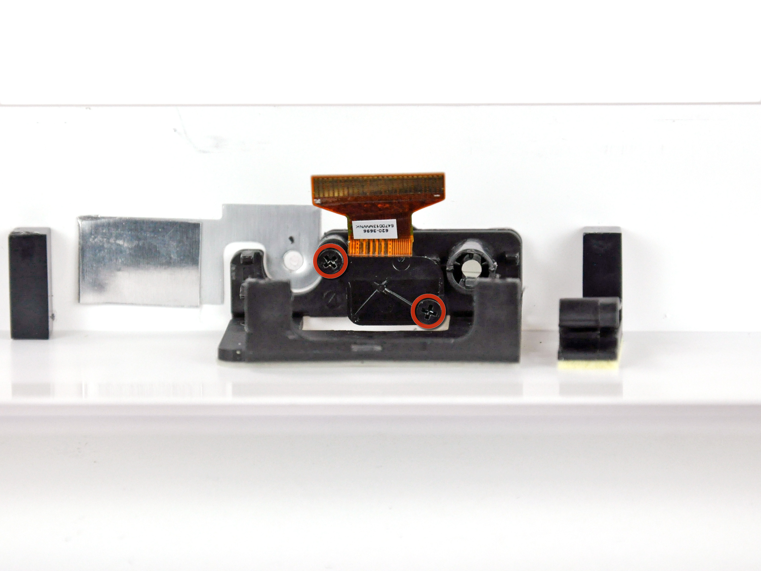

Add Note Edit Step 8 — Camera Board  ¶
  • If necessary, remove the strips of tape covering the camera board.
  • Don't forget to reapply tape to the face of the camera board to avoid electrical shorts.
