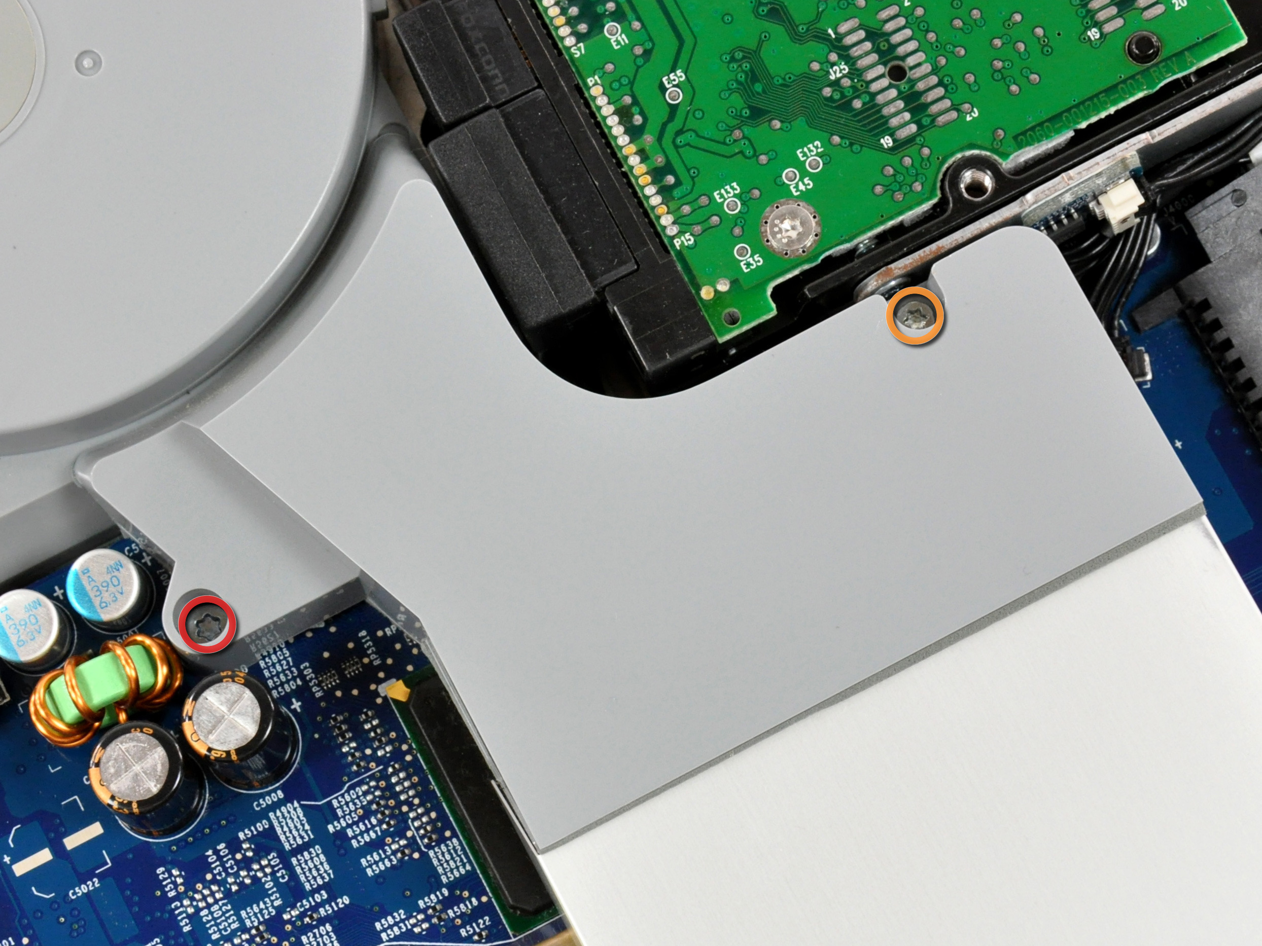

Add Note Edit Step 3 — Fan Duct  ¶
  • Remove the following two screws:
    • One 11 mm T10 Torx.
    • One 10.6 mm T8 Torx.
Image #1
Add Note Edit Step 4  ¶
  • Lift the fan duct out of the chassis.
