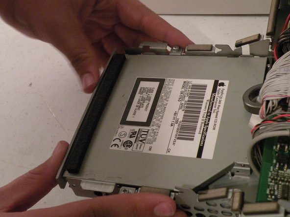

Add Note Edit Step 9 — Optical Drive  ¶
  • Now to remove the optical drive!
Image #1
Add Note Edit Step 10  ¶
  • The optical drive is located near the front of the assembly.
Image #1 Image #2 Image #3

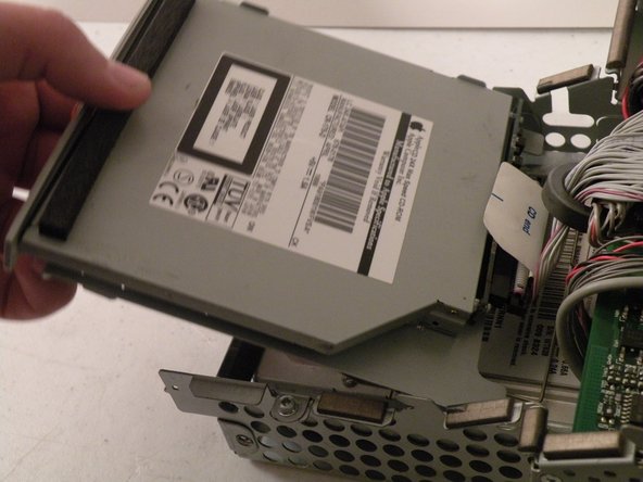

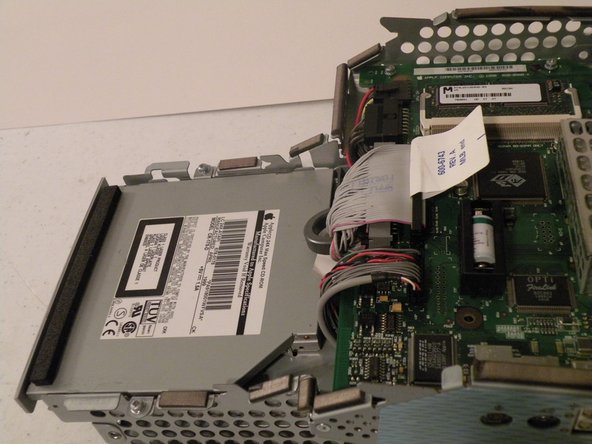

Add Note Edit Step 11  ¶
  • To remove the drive, push it in, lift up, and then pull forward.
  • As you pull the drive forward, disconnect the ribbon cable and set it aside.

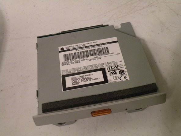

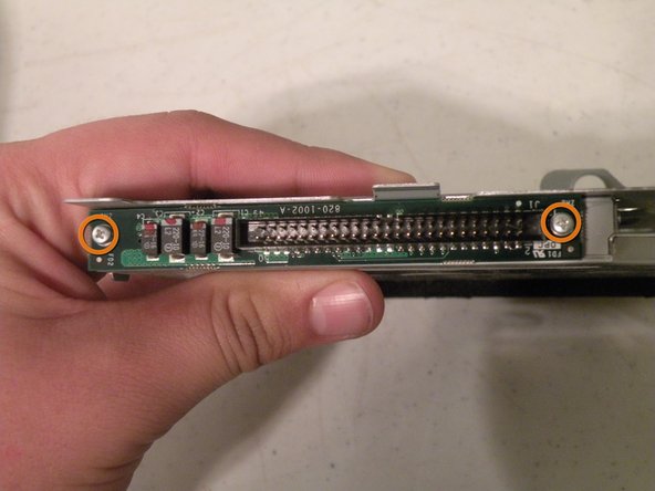

Add Note Edit Step 12  ¶
  • Remove the two phillips #00 screws.
  • Then remove the board. This will reveal that it is a standard PATA drive.
  • Congrats, the drive is free! You can use any PATA-tray loading drive in the iMac G3 which means you can install a CDRW to burn CDs in OS9 or X(if using OSX,install that DVD writer) but, of course only original drives will match the great look of the iMac).

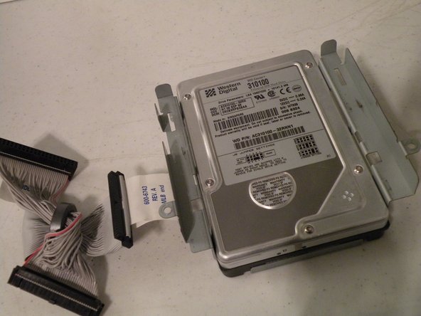

Add Note Edit Step 13 — Hard Drive  ¶
  • Hard Drive Removal:
Image #1 Image #2

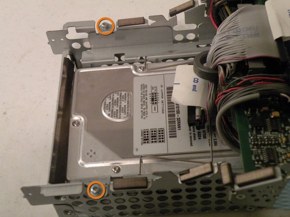

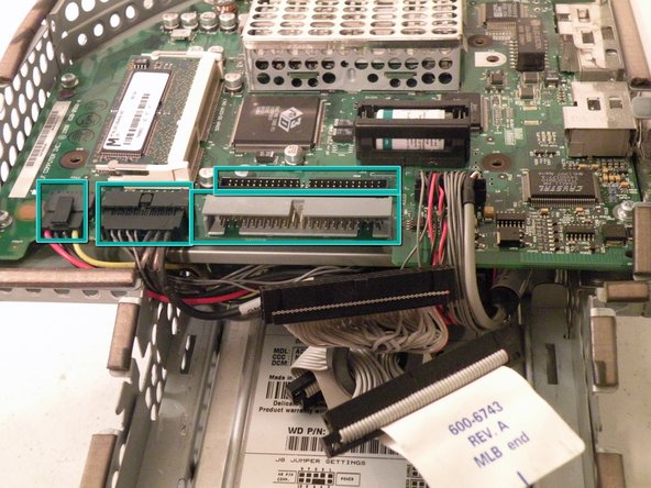

Add Note Edit Step 14  ¶
  • Start by removing these Phillips screws:
  • Now, remove all of these cables:
Image #1 Image #2

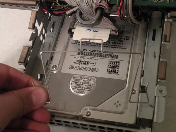

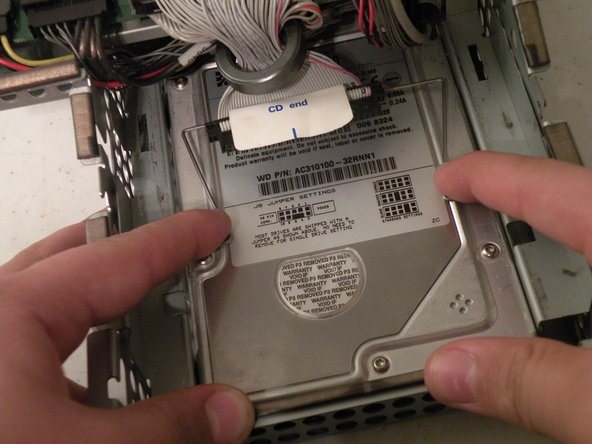

Add Note Edit Step 15  ¶
  • Now, remove the optical drive retention spring.
  • Push in on both sides, and pull towards you releasing the retention spring.
  • It may help to do it one side at a time.

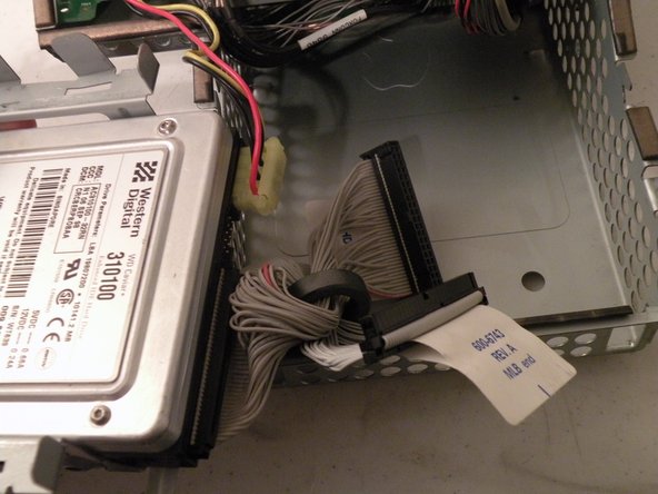

Add Note Edit Step 16  ¶
  • Now lift the drive up, and pull it out.
  • Make sure that no cables are snagged before completed pulling out the drive!
Image #1
Add Note Edit Step 17  ¶
  • When installing a new drive, make sure that the drive jumper block is set to "Single drive". In most drives, this means removing the jumper, or positioning the jumper horizontally instead of vertically, so you don't lose it.
  • To remove the drive from the metal caddy, remove these four screws from the side of the drive.
