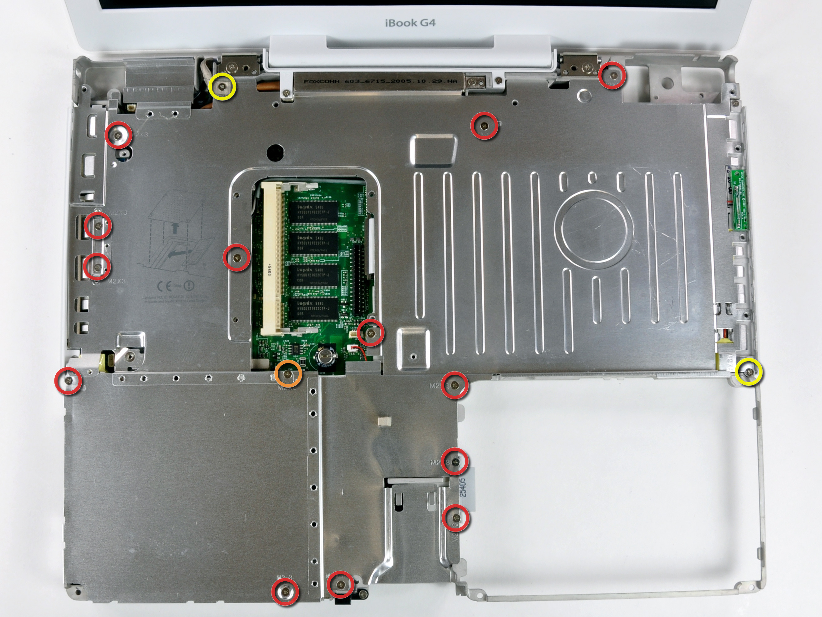

Image #1
Add Note Edit Step 25  ¶
  • We recommend placing the computer on a soft cloth from this point on to prevent damaging the logic board.
  • Turn over the computer and open it.
  • Remove the 3 Phillips screws from the edges of the keyboard area.
  • The shorter screw goes in the lower left corner. The left corner is indicated by a blue "L" in the photograph and is on the right side.
Image #1
Add Note Edit Step 26  ¶
  • Be especially careful while disconnecting the cables in the forthcoming steps. Never pull directly on the cables, but use a spudger to pry up the connector directly from its socket.
  • Lift the upper case and use a spudger or your finger to disconnect the trackpad connector hidden beneath the white plastic tab.
  • Be careful while lifting the upper case, as its tabs are still hanging on the metal frame.
Image #1
Add Note Edit Step 27  ¶
  • The sockets attached to the motherboards of most iBooks are very weak and easily broken. Use extreme caution when pulling connectors out of their sockets.
  • Lift the upper case enough to disconnect the blue and white power cable from the logic board. Using your fingernails, carefully pry the connector from its socket.
  • Carefully disconnect the multicolored speaker cable from the logic board in the same fashion.
Image #1
Add Note Edit Step 28 — Top Shield  ¶
  • Remove the following 16 screws:
    • Thirteen 3 mm Phillips.
    • One 3 mm Phillips.
    • Two 4 mm Phillips.
  • During reassembly, be sure to fit the screw near the left hinge through the loop in the display data cable, securing the cable to the upper case.
Image #1
Add Note Edit Step 29  ¶
  • Lift the top shield up from the right side, minding the upper left corner which may catch on the metal framework.
