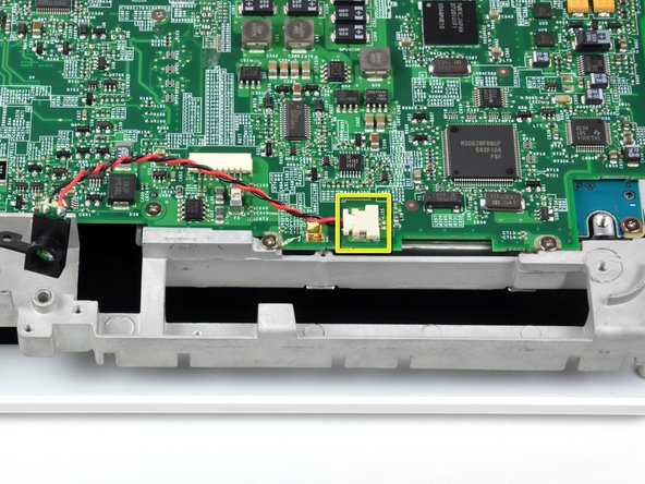

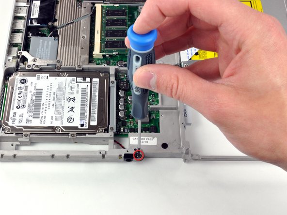

Add Note Edit Step 30 — Sleep Light  ¶
  • Remove the single Phillips screw securing the sleep light to the metal framework.
Image #1
Add Note Edit Step 31  ¶
  • Turn the computer over and disconnect the sleep light from the logic board, removing tape as necessary.
