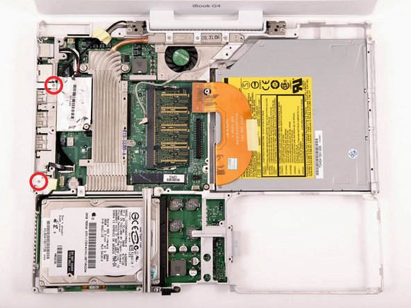

  • Lift the upper case off completely and disconnect the multicolored speaker cable from the logic board. As before, make sure you're pulling only on the connector and not on the socket.
  • Tip: the multi-coloured cable may be easier and less daunting to disconnect after removing the top heat shield. Prop the top case upright while removing the shield - the connector is then much more accessible.

  • Remove the following 15 screws:
    • Fourteen 3 mm Phillips.
    • One 5.5 mm Phillips in the upper left corner.

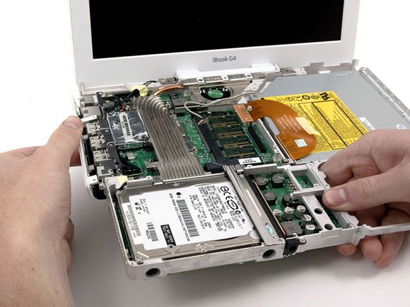

Add Note Edit Step 35  ¶
  • Lift the top shield up from the right side, minding the upper left corner, which may catch on the metal framework.

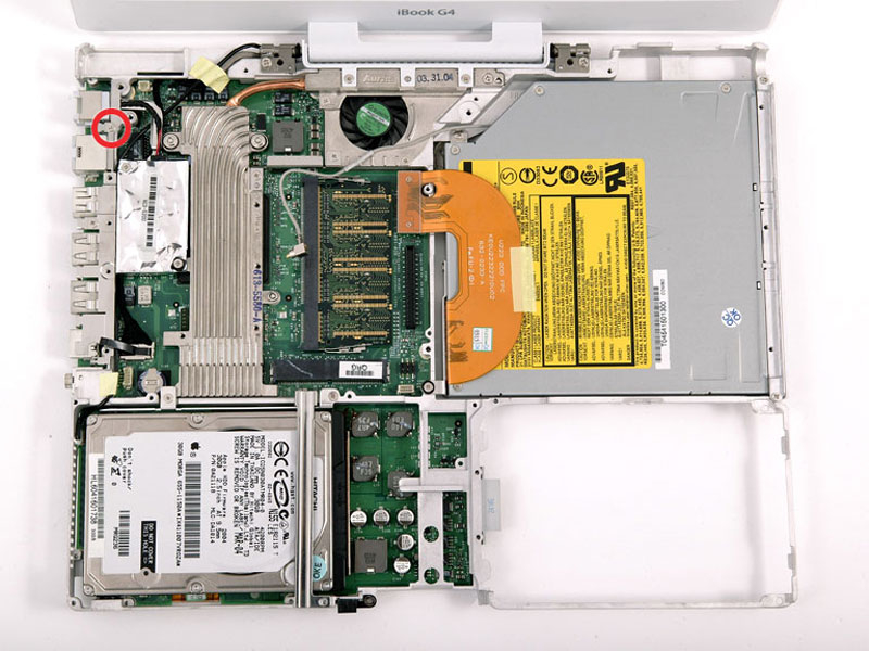

Add Note Edit Step 36 — I/O Bezel  ¶
  • Remove the two Phillips screws securing the white plastic fingers of the I/O bezel to the metal framework.
  • The longer screw goes into the longer finger, closer to the display.

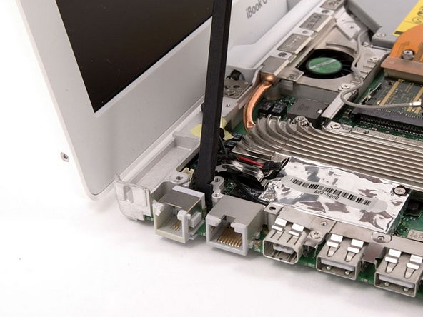

Add Note Edit Step 37  ¶
  • Lift up the left side of the computer and slide the I/O bezel away.

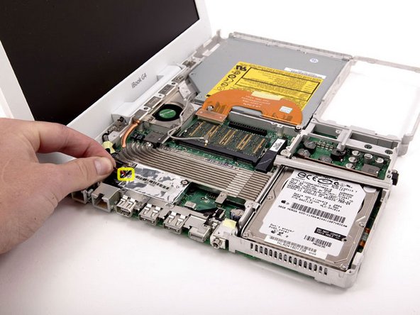

Add Note Edit Step 38 — RJ-11 Board  ¶
  • Remove the single Phillips screw securing the EMI finger to the metal framework.
  • The screw goes into the hole between the modem and ethernet ports.
  • Lift the silver EMI finger off of the metal framework.
Image #1
Add Note Edit Step 39  ¶
  • Disconnect the RJ-11 cable from the modem.
Image #1
Add Note Edit Step 40  ¶
  • Wedge a spudger between the RJ-11 board and the metal framework and slide the board off of the logic board.
