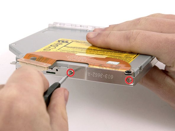

Add Note Edit Step 41  ¶
  • Remove the two Phillips screws securing the metal bracket and cable to the back of the optical drive.

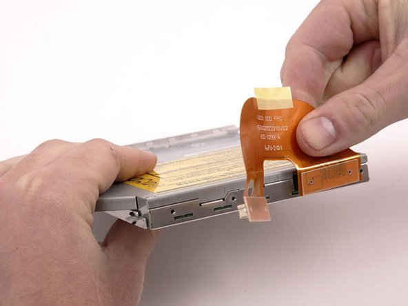

Add Note Edit Step 42  ¶
  • Peel the orange cable up from the top of the optical drive, removing tape as necessary, and disconnect it.

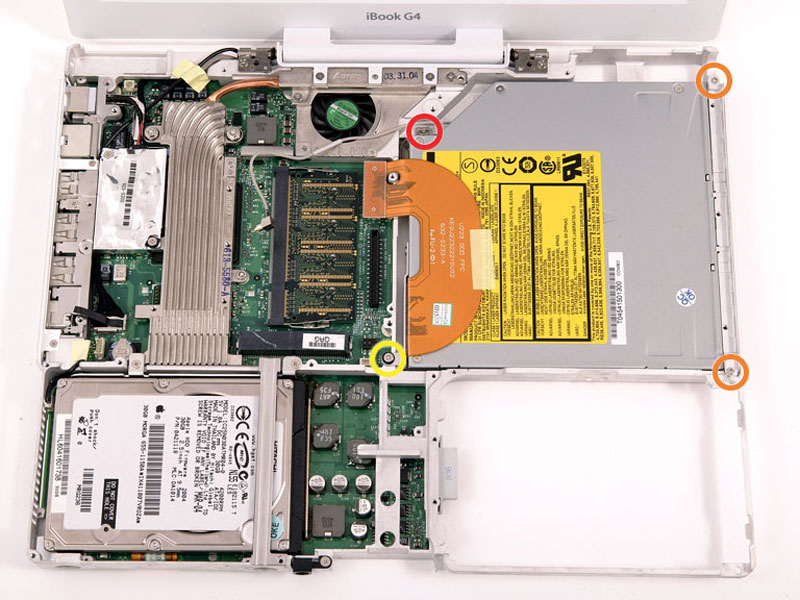

Add Note Edit Step 43  ¶
  • Remove the single Phillips screw securing the bezel at the front of the optical drive.
  • This screw is longer than the two that secure the bracket and cable at the back of the drive.

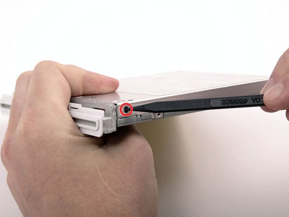

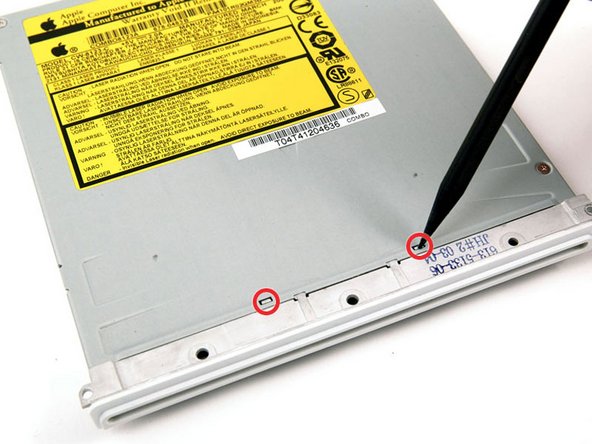

Add Note Edit Step 44  ¶
  • The bezel has several small, fragile tabs that will break easily.
  • Use a spudger to carefully depress the two tabs on top of the bezel.
Image #1
Add Note Edit Step 45  ¶
  • Hold the optical drive on its side and depress the remaining tab to free the bezel from the drive.

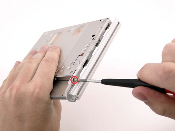

Add Note Edit Step 46  ¶
  • Turn the drive over and remove the two Phillips screws from the bracket on the side of the drive.
  • These screws are only partially threaded.
  • If you have a CD or any other object jammed in your optical drive, we have an optical drive repair guide.
